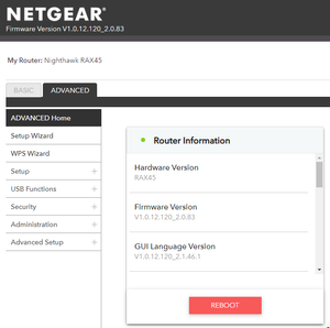

Hello Everyone, Another problem arose after plugging in the new nighthawk. My physical network 192.168.xxx.xxx which goes to port one on my JGS524Ev2 and is trunked is now not working....

I haven't as of yet. However, the link light on both ends shows green. I would think that means it's good. I have had the switch set up for a few years with the same config and never had a problem. So I am not sure what is going on with it.

Thats why its worth trying a different device.
to see if its actually a problem with the router or a setting on the switch.
You said the RAX is new so maybe its something you had setup prior on the switch.

Yup it could be, I am getting ready to replace the switch and try it. My old ASUS RT AC3200 was working fine and I don't remember anything special being done other than trunking port one on the switch.
