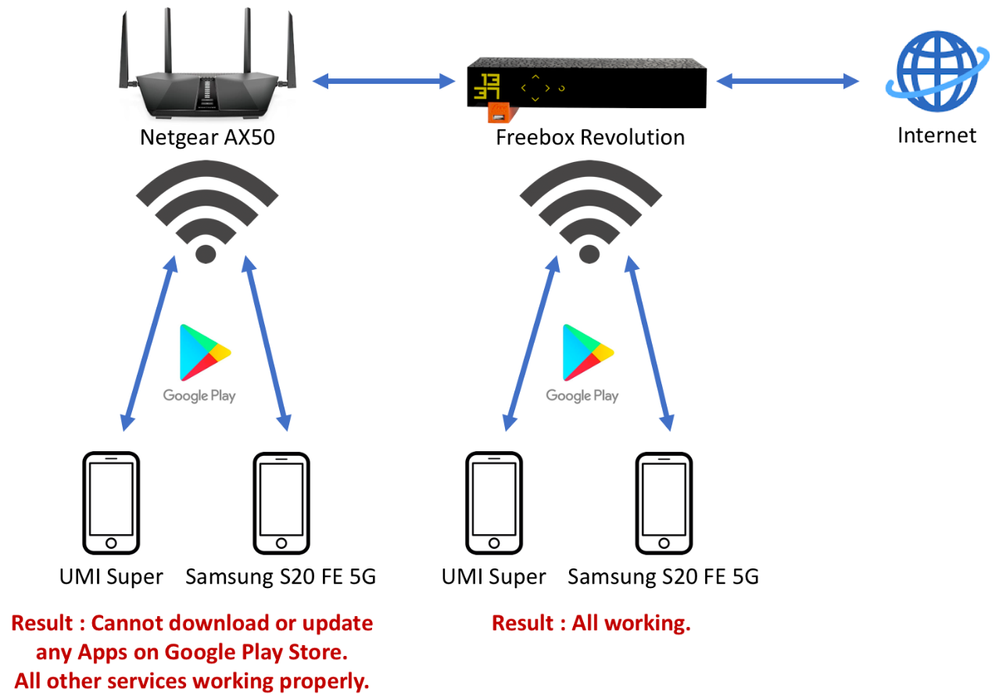

Firmware is V1.0.11.112_2.0.77, I will post some more details.
Behavior is really strange with Play Store : sometimes it never start the download and some others time it stuck at 99%. In all cases the updates or new apps never installed through the router (but works fine on others wifi or cell network).
Appart this issue it looks like everything is working pretty fine : browsing, streaming (like Netflix), etc...
The issue is definilty with the router, not my ISP, as another wifi router device connected on the same internet box as no issue with Play Store.

I have just tested with my old Android smartphone (UMI Super). It is based on an older version of Android but and I have exactly the same problem.
I have made a quick diagram to explain the issue. Will be happy to provide more details if necessary.

Seems that your ISP Modem (Freebox Revolution) has a router and wifi built in here? IF so, This would be a double NAT (two router) condition which isn't recommended. This would be a double NAT condition which isn't recommended. https://kb.netgear.com/30186/What-is-Double-NAT
https://kb.netgear.com/30187/How-to-fix-issues-with-Double-NAT
Couple of options,
1. Configure the modem for transparent bridge or modem only mode. Then use the NG router in router mode. You'll need to contact the ISP for help and information in regards to the modem being bridged correctly.
2. If you can't bridge the modem, disable ALL wifi radios on the modem, configure the modems DMZ/ExposedHost or IP Pass-Through for the IP address the NG router gets from the modem. https://kb.netgear.com/25891/DMZ-on-NETGEAR-routers
https://kb.netgear.com/24086/How-do-I-set-up-a-default-DMZ-server-on-my-Nighthawk-router
3. Or disable all wifi radios on the modem and connect the NG router to the modem, LAN to LAN configure AP mode on the NG router.
Try option #2 first...
