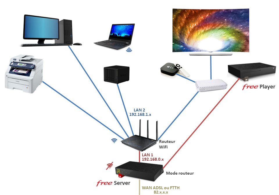

Just for the record : I have found an interesting topic on how to configure my box as bridge (in French sorry):
The tricky part is that my box is also providing TV through a dedicated extension box that needs VLAN 100 to work so I will have to either create a VLAN 100 on the RAX50 or keep on connecting my TV extension on my main Internet Box (set in Bridge mode).
I will test this and let you know.
