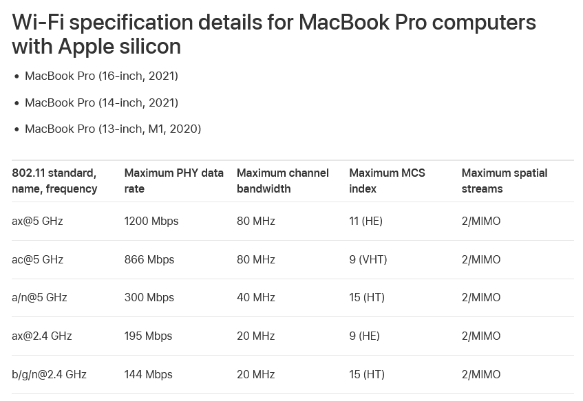

The M1 macbook supports 802.11ax, though due to either a hardware or firmware limit, they are limited to 80MHz channel width, which for 802.11ax, is effectively a 50% speed reduction for close to medium range.
https://support.apple.com/guide/deployment/macbook-pro-wi-fi-specification-details-dep2ac3e3b51/web

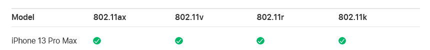

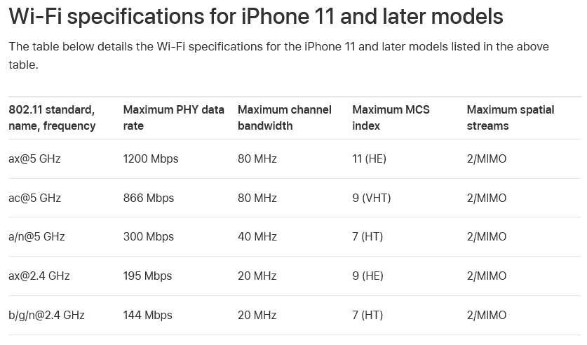

The iphone 13 Pro Max may also be limmited to 80MHz channel width. https://support.apple.com/guide/deployment/iphone-wi-fi-specification-details-dep268652e6c/1/web/1.0

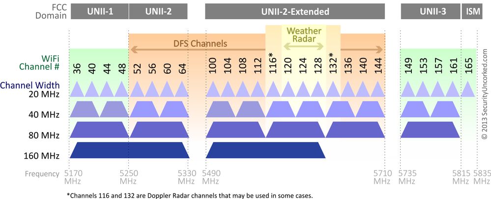

The channel selection depends on your region, as well as the channel width selected in the router.
Netgear doesn't really llist the channel widths, and instead list them based on PHY rate.
Up to 4800 Mbps = 160MHz channel widthUp to 2400 Mbps = 80MHz channel width
Up to 1200 Mbps = 40MHz channel width
Up to 600Mbps = 20MHz channel width
The wider the channel width, the fewer channel options there will be since the channel width needs contigious spectrum (enough 20MHz channels in a row that can encompass the channel width selected. Since there are gaps in the 5GHz band due to FCC restrictions (different countries will have theirown set of arbitrary restrictions), the selection for 160MHz is quite limited.
The image below shows the channels after the arbitrary FCC restrictions in the US.
