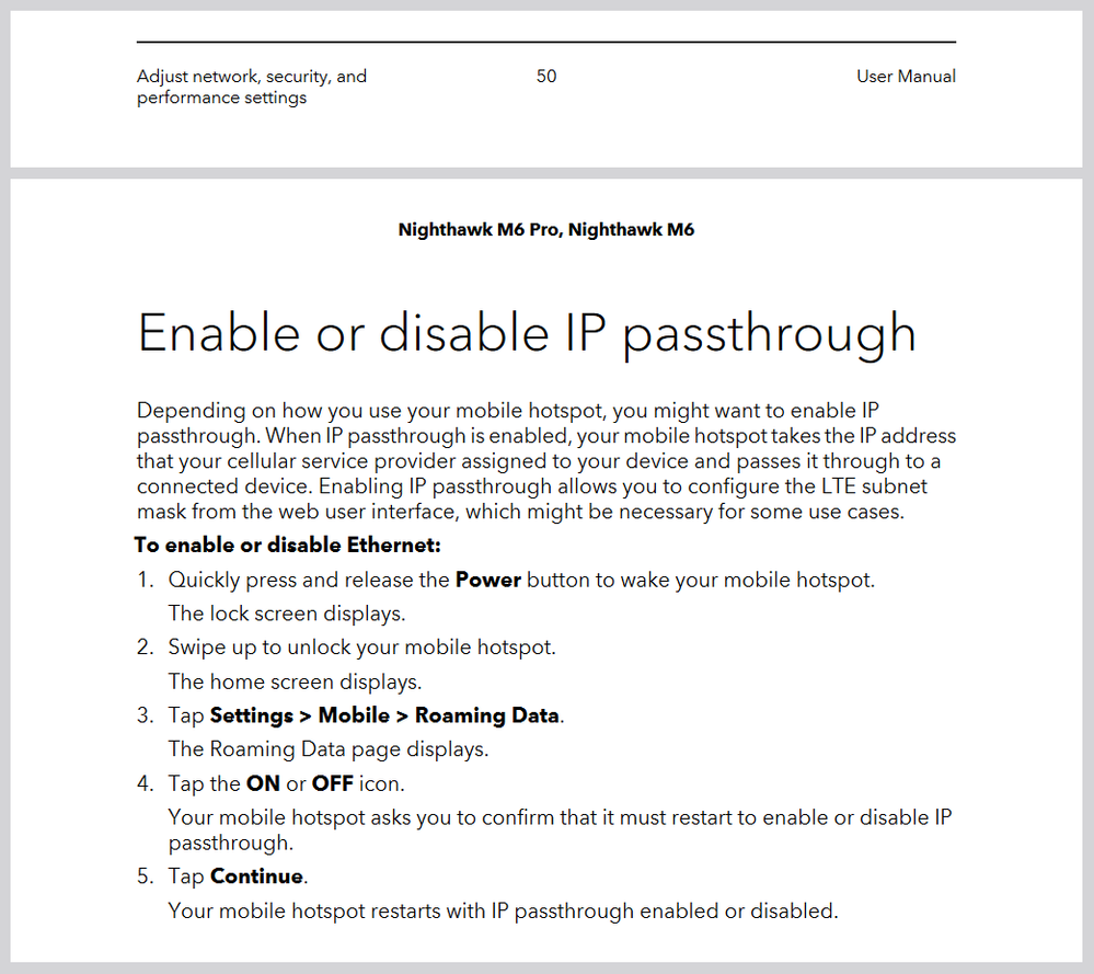

    • Anonymous's avatar
      Anonymous
      read detailed information with concise instructions about M6 Passthrough carefully in the M6 User Manual  (p51)
      these instructions explain everything you need to know to enable or disable Ethernet via the Roaming Data setup page.
      you'll be quizzed on it later.
