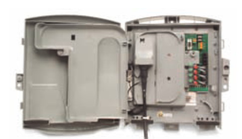

For the ONT, are you using one of the Alcatel-Lucent 7342 style ONTs from Verizon?
If so, try using the same WAN port MAC address as the R6700 router and see if it allows you to connect. if it does, then it means that your model is also having one of the annoying behaviors where if you swap to a different router, it refuses to allow you to connect to the internet unless you use the same MAC address unless you literally power the ONT off for a few minutes.
I am unsure if their other models experience this, but I know a few users who experienced it after they moved from older BPON units to the GPON ones where a number of years ago, was the Alcatel-Lucent units.

Razor512 The ONT on the outside of our building appears to be an Alcatel-Lucent O-821 M-E. I am 95% certain this was the original hardware installed back in the early 2010s when FiOS was first available for our location. I did a quick Google search on this model and saw some hits from dslreports about other FiOS customers getting this replaced for one reason or another, but nothing specifically said with my exact issue (or at least from what I could understand). I saw some users comment about Ethernet 1 and Ethernet 2 ports on the A-L hardware. The cable is only plugged into Ethernet 1 on our box. I don't know if this makes a difference.
So from what I understand, this specific ONT must not like newer routers?

If they are assigning a static IP via DHCP, try releasng the DHCP lease (on the connection status page in the advanced tab) on the old router. While it may not seem like much, on the older Alcatel units it allows for a swapping of a router without powercycling the ONT.
Whie the Fios network overall doesn't care about the MAC address, some of the ONTs they used many years ago had weird issues like that, especialy the ones with multiple WAN interfaces such as the MoCA and Ethernet, or dual Ethernet port ones. It is overall a strange issue with some of the units.

Razor512 The issue has been resolved with a Verizon tech on-site! We were able to get internet with the Verizon router, but he troubleshooted that there was something suspicious about the connection. It had to do with the RJ45 plug on the Ethernet wire from the ONT to the router. The plug was from the original installation back in the early 2010s when FiOS was first available at our location. He cut the existing plug andmade a new one for us. We then plugged it into the RAX48 and it now has internet!
I have no clue how the R6700 still was able to detect internet if the RJ45 plug was degraded in some way. Either way, this has now been fixed!
