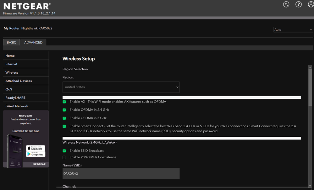

Not using smart connect.
I moved it all the way down to channel 36, no change in behavior.

Did you check if its set to the proper region?
- sammybkMar 15, 2023Aspirant
Yes, set to United States.

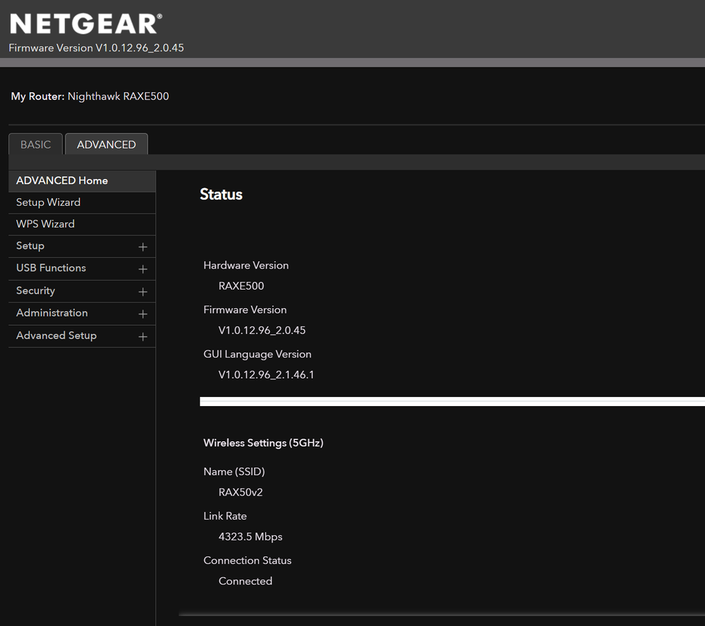

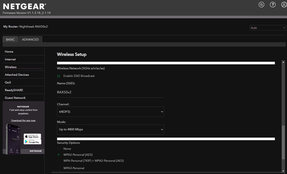

I checked out my RAX50v2 today with a RAXE500 in wireless bridge mode:
Set channel 64 DFS on the RAX50v2:
I'm impressed, 4300Mpbs connection rate seen on the RAXE500 at about 5 feet distance:
