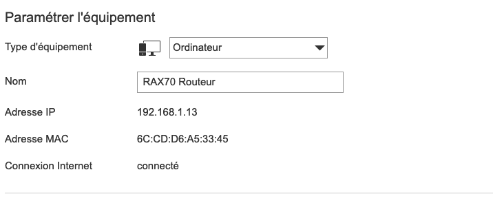

Thanks, the internet provider modem is the Orange Livebox , there is a 40 mtr ethernet cable because the house is big, and the RAX70 is at the end of this cable to have an internet point at this location, the two TV decoders are connected to the RAX70 in ethernet .
unable to connect to 192.168.1.13

I don't know where that screenshot comes from.
It looks like the Livebox is a gateway (modem/router). But it is hard to tell. There are different versions of the "Livebox".
Your image shows an "ordinateur". Google, and the icon, tell me that this is a PC.
screenshot is from the livebox 6
Livebox is manufactured by sagemcom
The Livebox 6 is a modem router designed specifically for fiber, providing access to Orange services such as internet, telephone and television. You can connect via Wi-Fi or Ethernet from your computers and other connected devices.
the orange livebox has put a default icon which is not correct, it shows a computer but it is indeed the RAX70 router
>You need to login to the web interface for the Livebox.
Customize settings of device RAX70 Routeur
IP address 192.168.1.13MAC address 6C:CD:D6:A5:33:45
