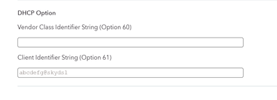

This firmware appears to have removed support for DHCP option 60 and 61 from the internet setup. This means I can no longer use the router with my ISP and have had to revert to V1.0.12.96_2.0.45 in order to connect.
Please can this be looked at and DHCP options be reinstated back into the firmware.
Anyone else who uses an ISP who relies on DHCP 61 (Sky in the UK) be warned this update will stop you from connecting to the internet.

Did you happen to try a factory reset and setup from scratch to see if DHCP option 60 and 61 from the internet setup or maybe placed in a different location with in the routers web ui pages?

Came home to find the router not able to connect to the internet after it had updated. I didn't try a full factory reset but did attempt to re-setup internet connection but upon selecting "Does your Internet connection require login?": No, there was/ is no option to choose/ enter DHCP option 61 settings like their is with firmware V1.0.12.96_2.0.45
I couldn't find it anywhere else but happy to be corrected if it is somewhere else or if doing a factory reset does show the setting.
