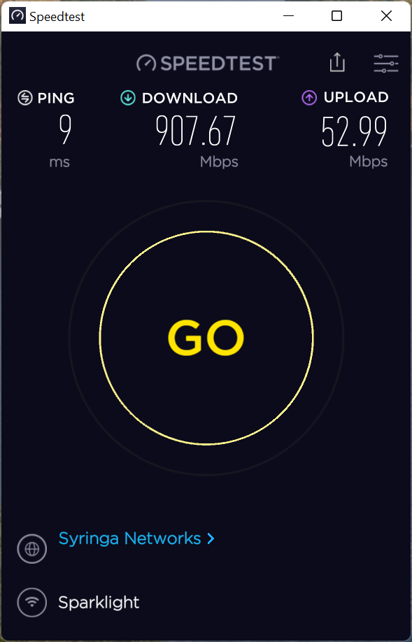

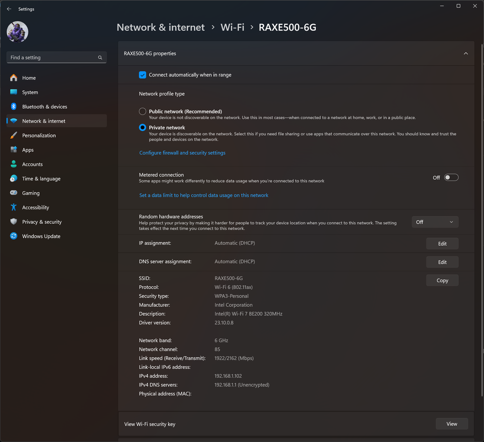

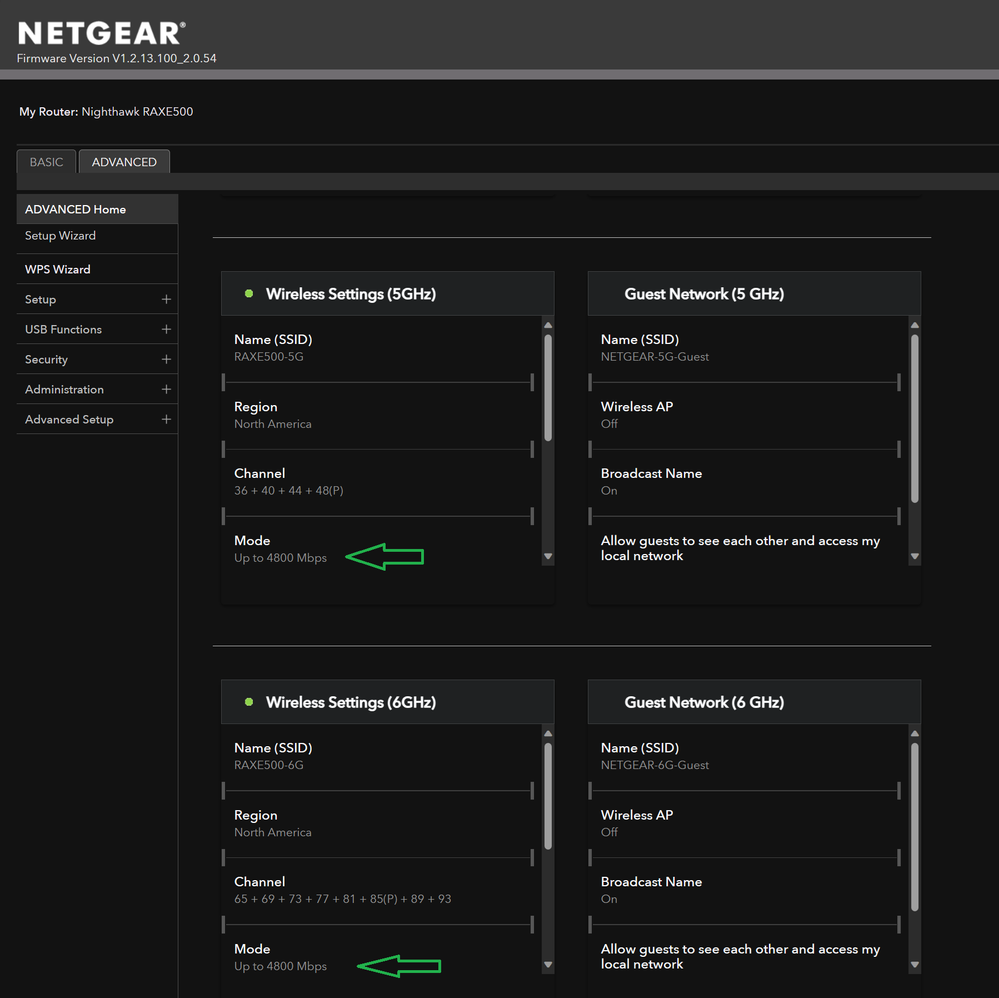

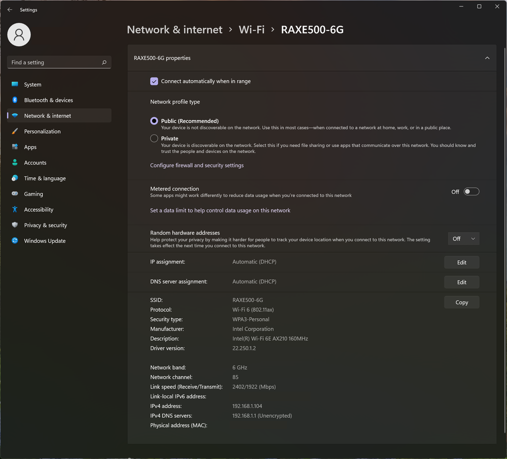

Put my RAXE500 online last nite.
v1.2.13.100
23 feet distanced between RAXE and two Windows 11 PCs.
Both connected on 6Ghz
OFDMA, Beamforming, MU-MIMO and AX features all enabled.
Up To 4800Mpbs on both 5 and 6Ghz radios. Manual Channels set for 48 and 85. Other channels won't appear set in the display. Only channels used in the set range are displayed.
Channel Config;
AX210 wirless adapter PC:
Speed reults:
BE200 wireless adapter PC:
Speed results:

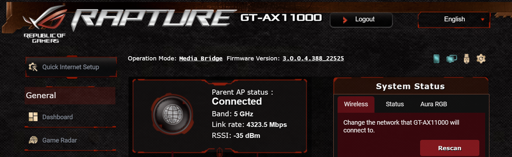

Near 4800Mpbs @160Mhzwith a ASUS-GTAX1100 wireless bridged mode connected to the RAXE500. All day long:
I'll never saturate this but the pipe is there and good.
