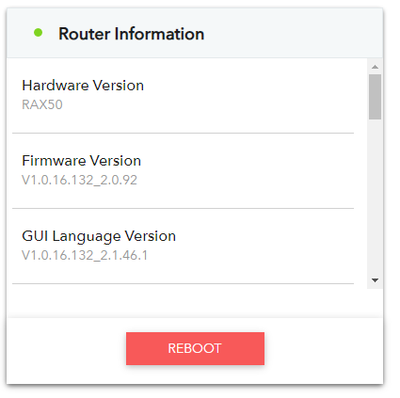

The Spectrum modem is EN2251, Hitron Technologies DOCIS 3.1 eMTA.
As for the firmware, here is what I see when I login to the router:
