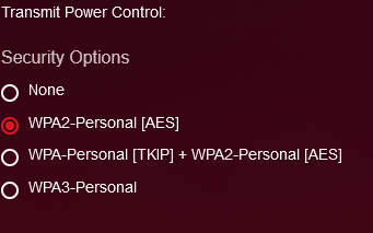

So my Ps5 won't connect to 5GHz wifi at all. 2.4GHz works just fine. Thats my Security option for 2.4GHz and 5GHz wifis. And as usual every other device runs just fine with XR1000 router.
