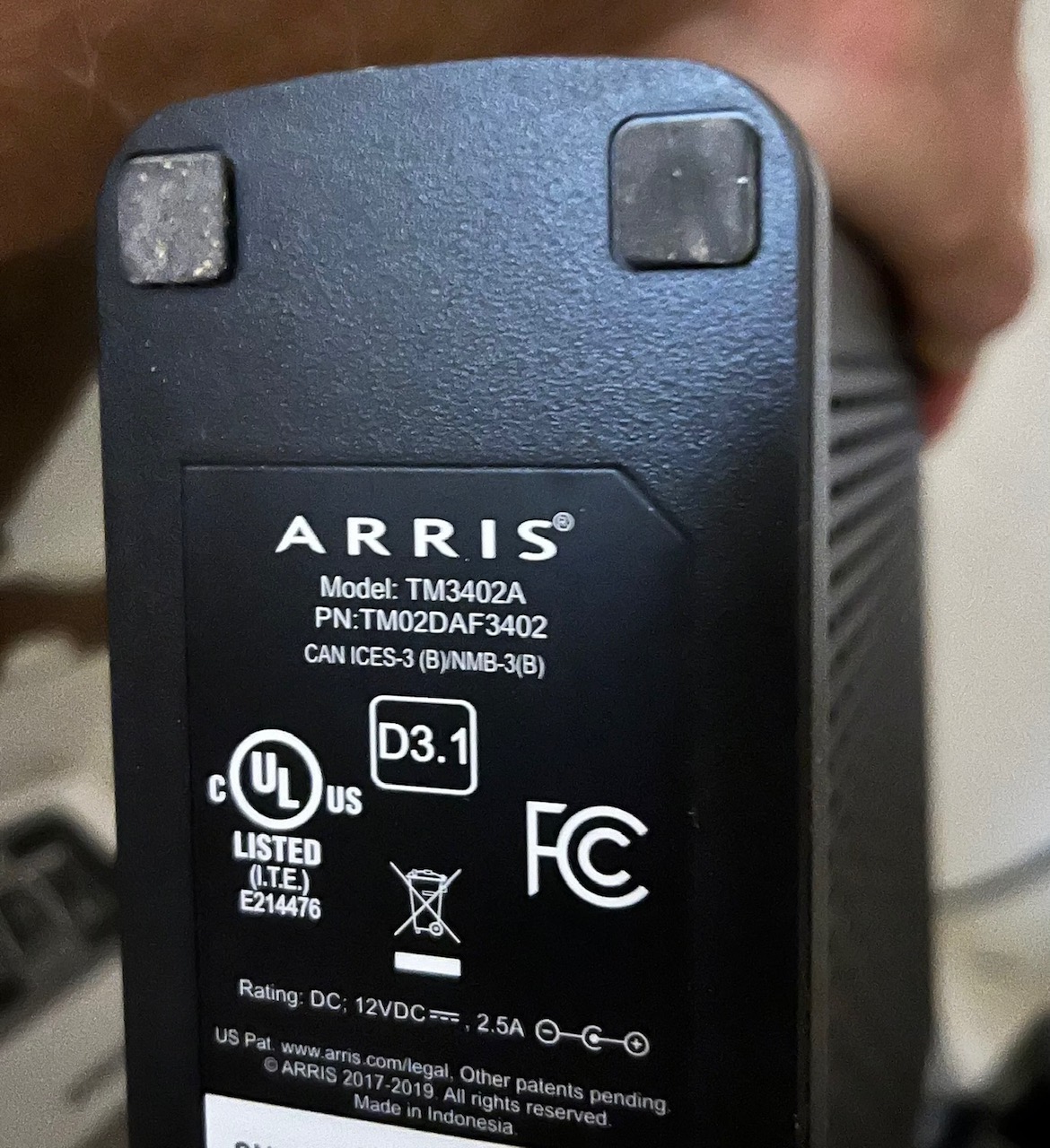

    What modem/gateway is the primary router connected to?

      Hi Plemans,
      It's an Arris TM3402A that's provided by our cable co, Cox.  So, TM3402A > R6700AX > Linksys EA7500 or
      TM3402A > R6700AX > Netgear Powerline AC1000 Wi-Fi Access Point
      FWIW, the R6700AX doesn't have any problem with other wired Lan devices, like A pc or TV, just the bridges
