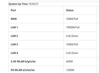

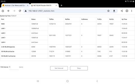

Beyond, a not so fun fact is that the RAX70 WAN port does run on Fast Ethernet (100 Mb/s) - in the year 2023 where people expect reliable and well performing Internet. Ok cuke2u can tell us this is expected due to the device making up the Internet connection connected on the WAN port, or because it's known the cabling between the RAX70 WAN port and the uplink device is just made from two cable pairs, or some crazy port-safer or cable-sharing adapters.
- michaelkenwardAug 20, 2023Guru - Experienced User
Well spotted. Those connection statistics are nuts.
The WAN and LAN ports in the router are rated up to 1000BASE-T. So why is it showing 100 Mbps on the WAN?
The LAN 3 at 100 Mbps is probably down to the device concerned. Many TVs are rated at 100BASE-T
The WAN may also be down to the modem and its specifications. But as cuke2u doesn't want to tell us what that device is, who knows what is happening?
