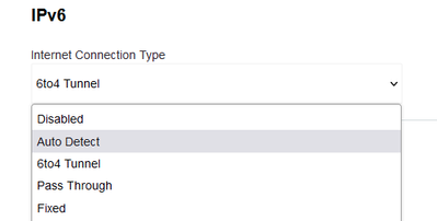

My router is randomly and intermittently turning off it's wired and WiFi connections, which means every device connected loses it's connection. It occurred several times yesterday and sometimes occu...
- Aug 20, 2023
The modem is a tp link TD-W9970 in bridge mode, but it has been 100% stable since I setup the netgear with it until recently, we're talking months if not years.
Anyway I took a look at the netgear settings and it looks like these disconnects might have coincided with some settings I put into the ipv6 page. So I've reset it to off for the moment and will test.
My bad if this issue was self inflicted...

Well I had another random router reboot yesterday afternoon after setting ipv6 to auto so I've disabled it again to see if things settle down.
In my case, and on a very different router, the "auto" thing is not something you enable and leave.
It begins a process that goes out and looks for the correct IPv6 configuration.
It is the same sort of process that the Internet wizard goes through.
You may just have to forget about IPv6. Out of interest, why are you trying to use it?

I guess I thought that as the SkyQ hub supports ipv6 then I should try to turn it on with the RAX70 as there are some benefits but yeah I might as well give up really as the constant rebooting of the router affects my network far greater than any positives.
Where did the SkyQ hub come from? I thought that your modem was the TD-W9970 in modem only (bridge) mode.
I don't think the modem is involved in this process. My router supports BT's IPv6. The modem is not involved in the router's IP management process.
If you really want to use IPv6, you could use the Sky hub in modem/router mode and put the RAX70 into AP mode. You then hit this:
Disabled Features on the Router when set to AP Mode | Answer | NETGEAR Support
So you will have to balance the benefits of IPv6 against the losses of AP mode.

As I have SkyQ and Sky broadband then they supplied the hub but I decided to replace the hub as I had many WiFi devices and as there is no way the sky hub can be used in modem only mode.
I'm not trying to setup the tp-link modem for ipv6, as it is running in modem only bridge mode, just the netgear. To use the netgear in ap mode is just of no benefit and a waste of money.
The method I'm using is very commonly used and as advised by Sky community users for dsl.
Just like BT and its execrable HomeHub.
I agree on the waste of money bit, but I have no idea why you say "no benefit". You said that you needed something to handle more wifi devices.
Another widely advised suggestion on the wifi front, especially with Mesh networks, is to put the second router into AP mode.
Pity you have a router that doesn't seem to support Sky's IPv6. But I still don't know why that is so important to you.
I forget, did you ever check if the TD-W9970 can support Sky's IPv6?
