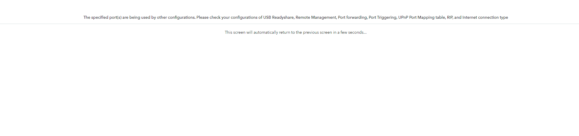

Hi i need to forward two ports
443 for 8123
and
5052 for 8098
Basicly on this router forward port is nightmare on other is just few click. I not forward anything but got messedge
I don't forward any port and all time got port is use check 10 places and port not found. This same net config i just take other router click forward and just work. Any help?

    • Robertbigk's avatar
      Robertbigk
      Initiate
      Ok great just don't want use brand names that why I write "other" but I can write sure np and yes just in port forward works no any issue.
      What I want to do ?
       192.168.1.5 is My home Assistant Ip address I try forward ports 443 for 8123 TCP
       192.168.1.10  is My Emby serwer Ip address I try forward ports 5052 for 8098   TCP
      What more I want to ? I want to just simple work nothing more choice all this setting and router that save that
      no give me mystique "The specific ports are being used by other configuration"
      -  USB Ready share not use but  ports not use in this menu 443 ,8123,5052,8098
      -  Remote Megament used other ports and (Remote is dissabled)
      -  Port Forwarding Clean setup no any rule setup for now
      -  Port Triggering Clean setup no any rule setup for now
      -  UPnP disabled to not mess any config setup but is no matter disabled enabled messed still persist and forward port not saved.
      Connect Rax 200 for one device just to can use Web Based config router show connected devices 1
      Still messedge "The specific ports are being used by other configuration"
      Other is:
      Ubiquity amplifi Alien
      Xiaomi AX3600
      I disconnect this Rax connect in this place "other" have that same config network wifi (names)
      I go to port forward choice:
      Click Click accept and work
       192.116.10  is My Emby serwer Ip address I try forward ports 5052 for 8098
      Ok I try to do that same witch Rax 200
      192.168.1.10  is My Emby server Ip address I try forward ports 5052 for 8098
      Ok next scenario i reset Rax 200 for factory reset no changes just leave all like default  "Wifi network names password from ressets" on (stickers from router)
      I go to port forwarding  write  that same
      port forward 192.168.1.5 443 for 8123
      port forward  192.168.1.10 5052 for 8098
      I do that all work and accept no any messedge router save setting
      Next scenario factory reset Rax 200 setup all from beginning change wifi name for what I choose i setup my internet connection (i got state IP address) Got internet connection status is good
      go to menu forward port
      I go to port forward i write  that same
      Messedge
      Last step i do that same
      on Other:
      Xiaomi AX3600
      I just write that same IP addresses and port forwarding work always no any error messedes conflict just router accept setting and start working.
      than if i got 3 different devices
      no any network changes config , cables different devices
      and on other  forward ports work instant save setting and just work
      On Rax 200 got all time
      Then don't tell is not nightmare got some mystique messedge port used and can save the setting.
      Sorry my English not superb but i try to explain that much detail what i can.
      Then what no difference in config and on others that same config work on Rax 200 get
      "The specific ports are being used by other configuration" used for what?
      And last info router on new firmware but I also try 3 older and that same problems
