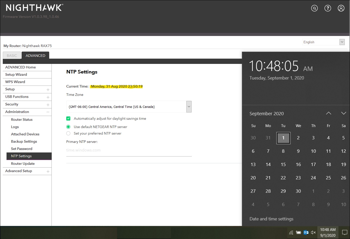

Using pool.ntp.org with GMT-06:00 timezone as NTP server or the Netgear server, the router retrives incorrect time and date (as of Sunday, 30 Aug 2020 13:56:43 CDT the rouiter shows "Wednesday, 12 Aug 2020 15:18:28") and never advances from that day, hour, or minute, but the seconds vary between 18 and 47 on repeated entry to the NTP page.
New firmware is required with correct NTP routine!

- steviev1Apprentice
Netgear pulled that firmware from their site. I actually downgraded back to .88
So far everything is good after that. I hope they get this fixed soon.
