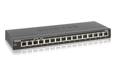

Sounds like you could use a switch.
Put that after the router and you can add as many devices as you like, within reason.
Switches are inexpensive. Mine has 16 ports. Most of them in use.
- TrainfireDec 15, 2023Aspirant
A switch could work actually, however I would still want Wifi in my garden house, but that could be arranged with a wifi access point hooked up to the switch maybe?
