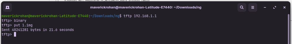

- Run in terminal:
tftp 192.168.1.1 >binary >put 1.img (don't presss ENTER now, for this line)
- Power off the device, hold the RESET button, power on device, keep RESET holding all the time
- After holding for about 20~30s, the device's power LED enters into a fast blinking status(and if you ping 192.168.1.1 in another terminal you start to get response). Release the RESET button.
- Press ENTER button in the tftp.
- Wait for transfer to finish(there is no message indicating tftp is working during transfering, but use ifconfig you can see traffic going out at a few MB/s). After transfer is done, you will see success message from tftp.

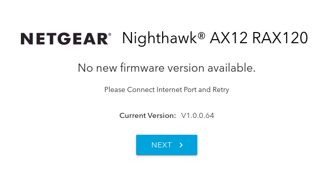

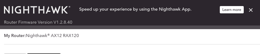

Solution is to use the method in the link above but loading v1.2.8.40 (latest as of June 2023) or v1.2.3.28 (last know good version) did not fix the WebUI lock out ERR_CONNECTION_REFUSED issue.
I had to downgrade it to v1.0.0.64, get access back to the Web UI and then upgrade back to v1.2.8.40
