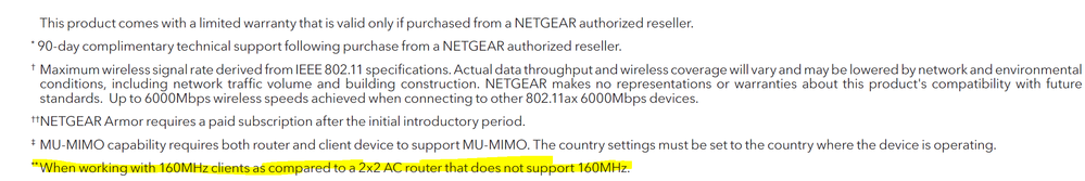

Mar 25, 2021Prodigy
https://www.netgear.com/images/datasheet/networking/wifirouter/rax120v2.pdf
As per datasheet what is highlighted yellow condition means . Its not clear.

- Christian_RApr 13, 2021NETGEAR Employee Retired
Hello mondenath,
The RAX120 can support 11AC and 11AX HT160 at the same time. When the RAX120 is set to HT160, it will have only 4 streams. If the WiFi client only have one atenna(1x1), the router can support 4 clients HT160 by MU-MIMO. The total throughput can be higher than 1773/2400. However, each client will not be able to get max 1733 or 2400.
