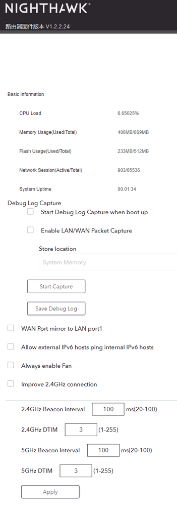

I stumbled upon your post because my router RAX120 has been running hot and the 5GHz keeps going out. I found some info somebody else posted about their system getting hot. Try "ip address/debug.htm". I found a setting that says " Always enable Fan". I checked it and hit apply and it looks like the setting stayed. I just checked the fan and holy crap, it's on! HOT air is coming out and I hope this fixes the performance issues. I have a feeling the 5GHz radio was turning off due to overheating.

I'm sorry but I do not have access to an RAX80. I did try the debug.htm on my netgear switch and received an Access Error. Here is a screen shot from the debug.htm on my RAX120. I updated to the latest Hot Fix firmware, V1.0.1.118, and the fan was unselected when I checked it this morning.
- Jacek26Feb 26, 2020TutorYeah I just compared my settings with yours and the enable fan setting is missing on my RAX80. Perhaps it’s only rax120 setting.

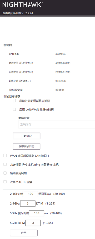

完美解决风扇不转的问题,感谢!

Use "192.168.1.1/debug.htm" to get to the debug page. Just check the box labeled "Always enable fan". If you reboot the modem this will get unchecked so you will have to keep checking it. Do not click the apply or save buttons. I made that mistake and it actually saves other unwanted settings. Not sure why the firmware developer does not put this setting in the unhidden pages. This thing gets hot so I guess they want it to burn up sooner so you have to buy another one. I have my router sitting on a short shelf so I can not raise it up higher and do not want to relocate it.
