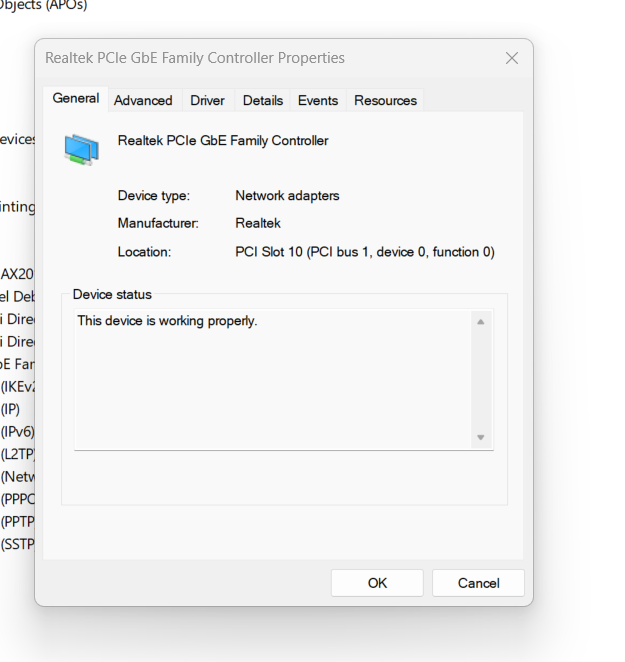

What is the brand and model# of the ethernet adapter in this PC?

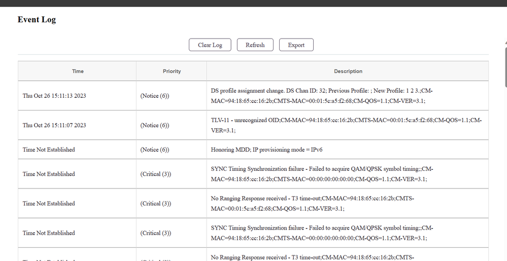

Any Criticals, Errors or Warnings seen in the modems event logs needs to be reviewed and resolved by the ISP. Indicates a signal issue on the ISP line up to the modem.
Please post a copy and paste of the modems connection status and event log page.
https://kb.netgear.com/30007/How-do-I-obtain-the-cable-connection-information-from-a-NETGEAR-cable-modem-modem-router- Retired_MemberOct 27, 2023

3. PC ethernet controller
4. There was an issue with the activation of the CM2000, but has been running fine as far as I can tell. Shows the white connection indicator when connected to the 1Gig WAN port and blue when connected to the MGig port.
