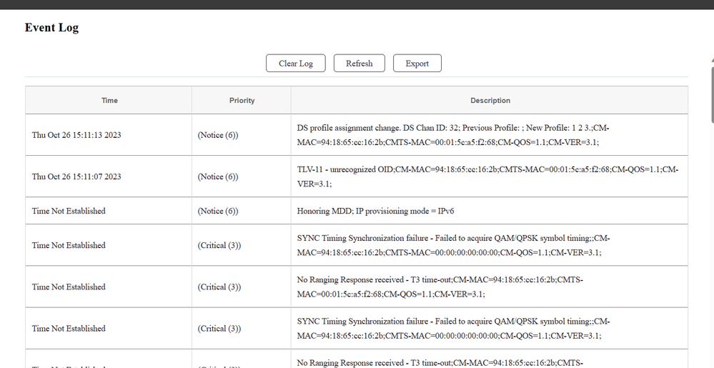

RAX120 internet speeds slows when using the MGig port with a CM2000
When connecting from my new CM2000 to the RAX120 using the MGig port, my internet speed drops from 900Mps (800 Mps service) to 650Mps. The Nighthawk IOS app test speed says it's working, but my hardw...

1. LAN 4 is connected to an Ooma VIOP. My testing has had this connected and not connected without any difference.
2. I change the router IP starting address for security reasons.
3. PC ethernet controller
4. There was an issue with the activation of the CM2000, but has been running fine as far as I can tell. Shows the white connection indicator when connected to the 1Gig WAN port and blue when connected to the MGig port.
