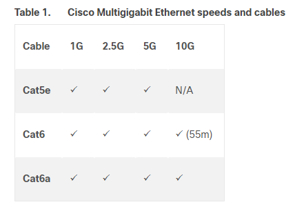

- schumakuDec 11, 2023Guru - Experienced User
The reason why the MultiGig standard was established as it was to protect the existing investment in CAT5, CAT5E, and CAT6 cabling out there in the field (with hundreds or thousands of exiting port installations). GbE, 2.5G, 5G does run over good Cat5e installations, 10 GbE is limited to about 55 meters (including patch cables), Cat 6 or better does support full 10GbE with ease, on 95 meters with installations (plus patch cords max 100 m).
If you expect even faster speeds over copper Ethernet, with Cat. 8.1, the maximum cable reach will be limited to about 30 meters for 40 GbE, resp. 24 meters for 25 GbE - a big investment, and major change in the building and cabling structure. All numbers borrowed from https://rdm.com/ (Reichle & De-Massari AG).
