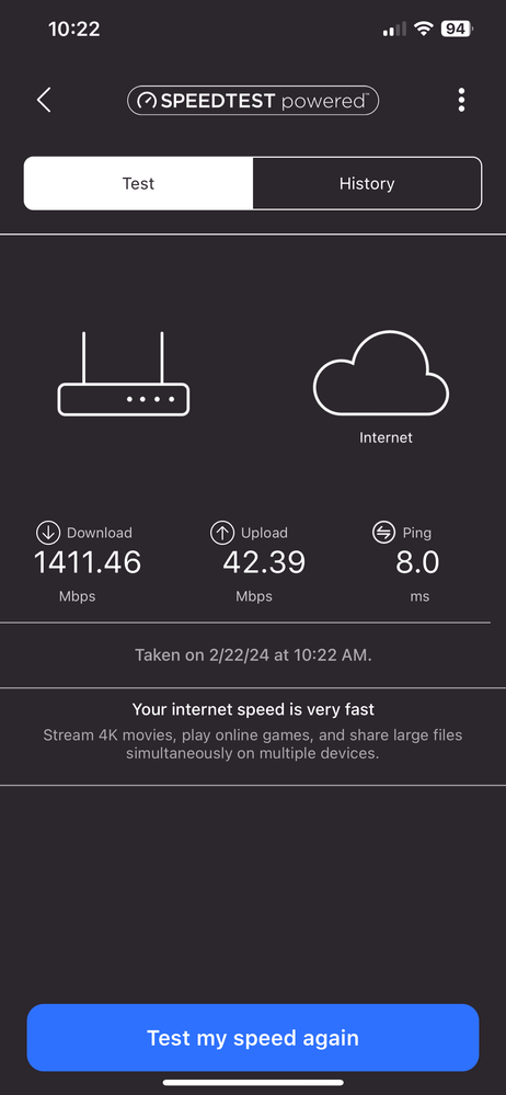

1. To be connected to the S33's multigig port - Completed
2. to be connected to the RAX120's multigig port from the S33 - Do I change the below setting to 5G Ethernet port or the Wan Aggregation?
Thank you again for your help!

If you've connected it to the 5g ethernet port, you'll change it to that port.
Then check the wan port statistics to ensure its connected at multigig speeds
- RAXuserFeb 22, 2024Guide
plemans You are amazing...... you literally saved me from doing something stupid (buying a RAXe500) today. Thank you so much! I went from 940MB to 1.4GB!!!!

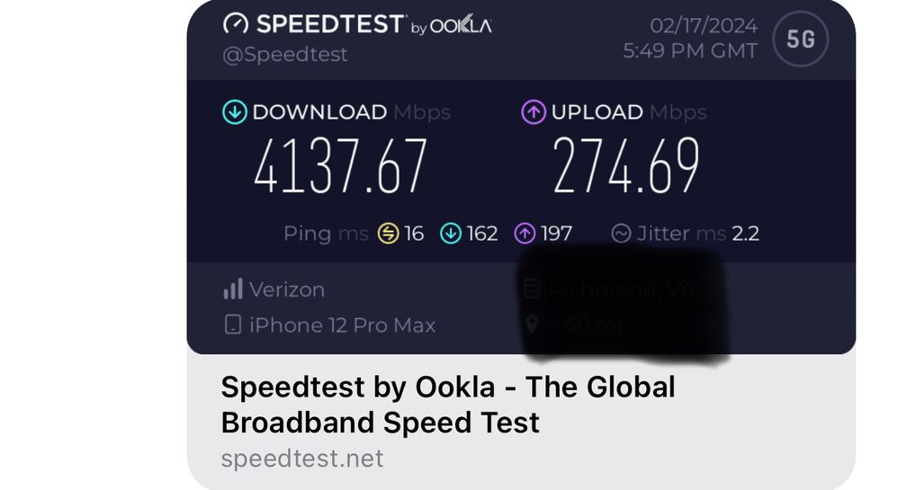

I checked.... not available yet in my market. I am however looking to dump Xfinity for Verizon 5G home..... I need to install an antenna (check out natar tater on youtube) to get the best 5GUW signal... Here is a the speed I get on my old iPhone 12 standing outside. It is incredible.
