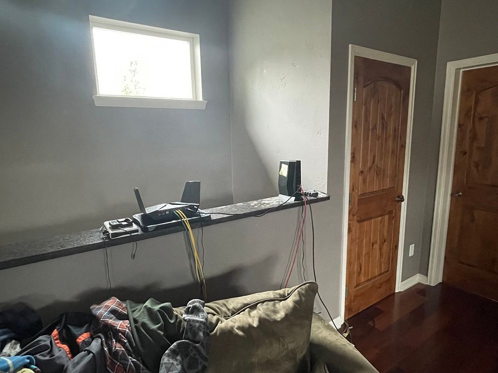

The one I have does have speed control and sets the router off the surface. Router does NOT have to be off the surface of the laptop cooler as well. There is plenty of air flow. Also you don't need high speeds for additional air flow, just some additional is all that needed. Based on size of fan as well, a larger fan liked the one I link here carries plenty of air flow at low speeds. Nearly silent as well.
This is the one I currently have for about 5 years after my first cheapy I got from Walmart, fan blades busted on it:
This has adjustable back legs too if needed.
How mine is deployed:
