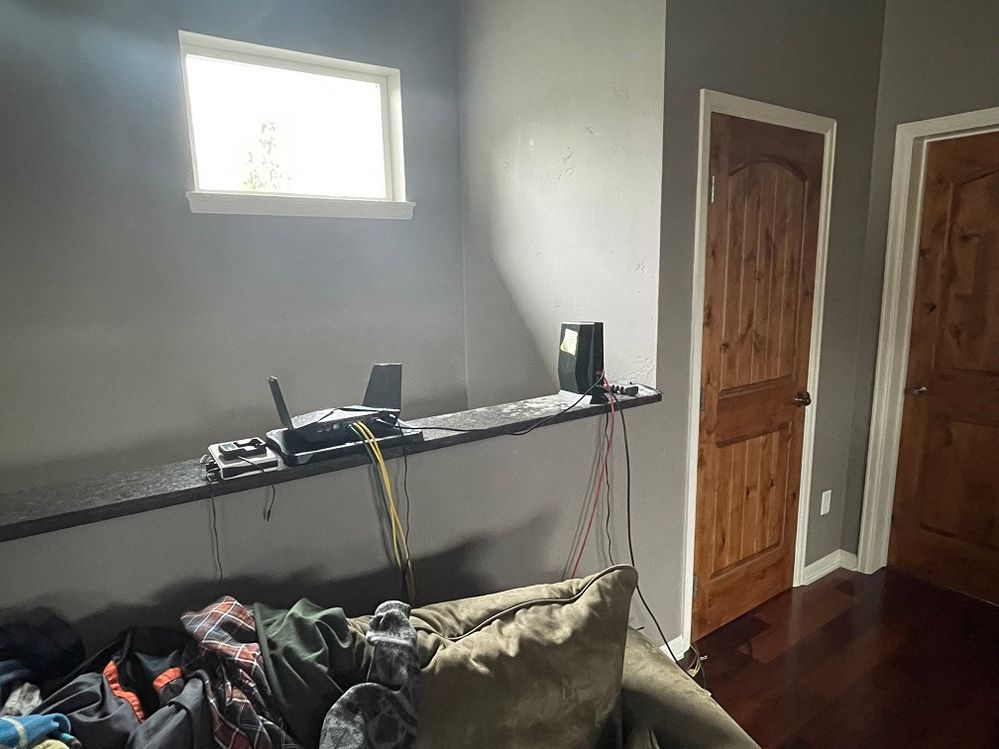

 - Eric35Jun 25, 2022GuideI did like this, look at the pictures > .
 - Eric35Jun 25, 2022GuideThe second photo
