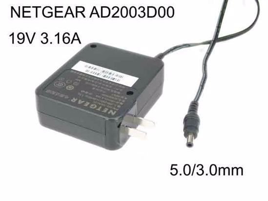

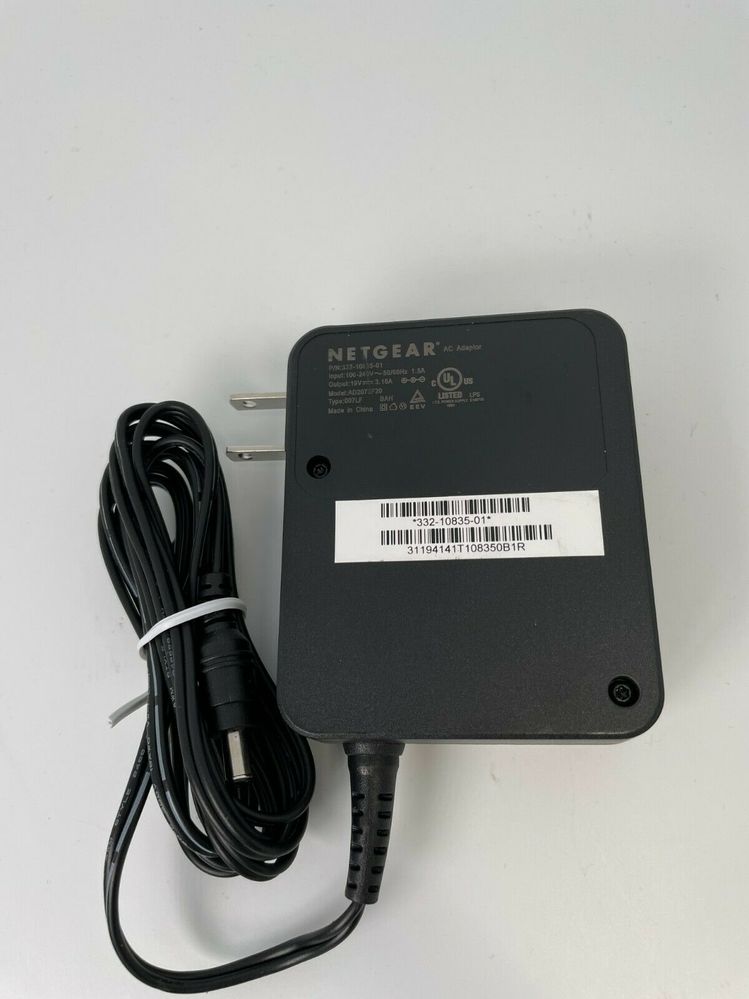

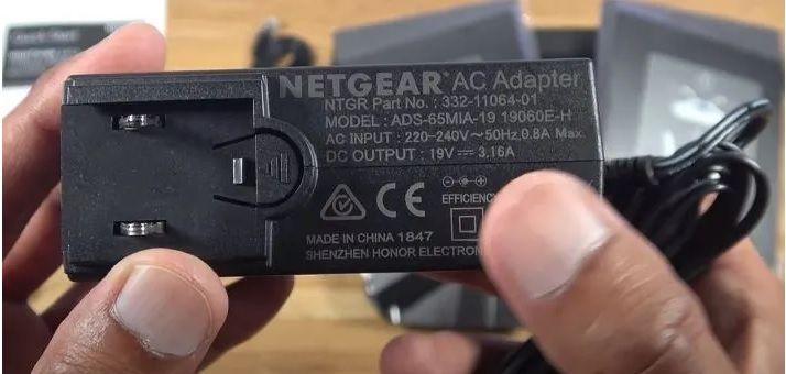

It came with this power adapter:
USA adapter, as supplied in the box
- _NDS_Jul 29, 2022Apprentice

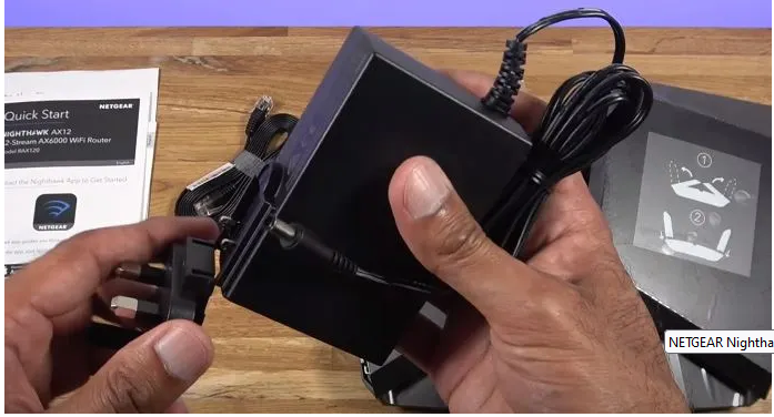

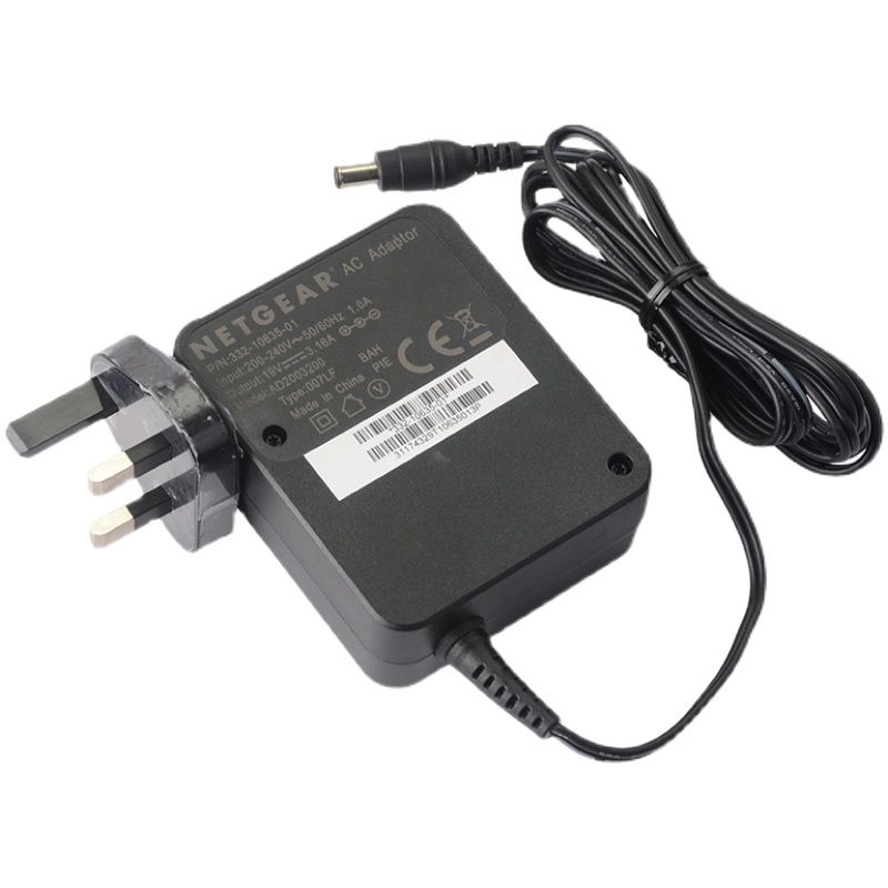

I noticed that the UK version of RAX 120 was supplied with a different adapter model, though an equivalent one to the one I got from the USA does exist for the UK market.
This is the UK power brick
As you can see it is quite substantial in size. I started wondering why has Netgear chosen to change the adapter model though they have a perfect equivalent to the one in the USA?
Here it is:
Please note, all three adapters have the same output voltage, current and power (19V, 3.16A, 60W). I concluded, that the European arm of Netgear was aware of the potential instability of the RAX120 router with the adapter model AD2003200 and replaced that model with a different one for a reason.
So, with great difficulty (Netgear doesn't sell their power adapters directly) I sourced the correct UK/ EU supplied power adapter (model ADS-65MIA-19), powered the RAX120 V2 router with it and hey presto - it has been stable for exactly one week without a reboot.
The router is stable, does not restart, does not drop connections, the cooling fan comes on and switches off regularly - as it should.
Therefore, the root cause of the random reboots problem is not in the firmware, not in the poor cooling, but in the inadequate features of the AD2073F20 power adapter the RAX120 v2 model is supplied to the US customer base.
Ironically, Netgear themselves state in their help pages on their website that incorrect power adpater may cause their routers to 'misteriously reboot'. Information about power adapters on Netgear products.
However, up until now thet have not found the source of the random reboots problem with the RAX120 v2. 🤣
Solution: RAX120 v2 owners in the US nag Netgear for a replacement power adapter

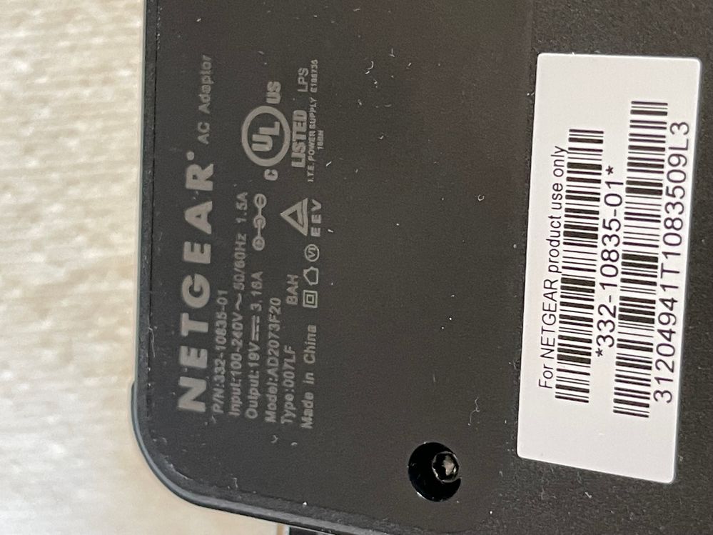

Here is my RAX120 PS:
- _NDS_Jul 31, 2022Apprentice
Yes indeed, the adapter included in the box is the one you showed AD7023F20 (I used stock picture in my first post and could not replace it later).
This power adapter - AD7023F20- is the one that's causing the random reboots, as it clearly doesn't meet the requirements of this particular router.

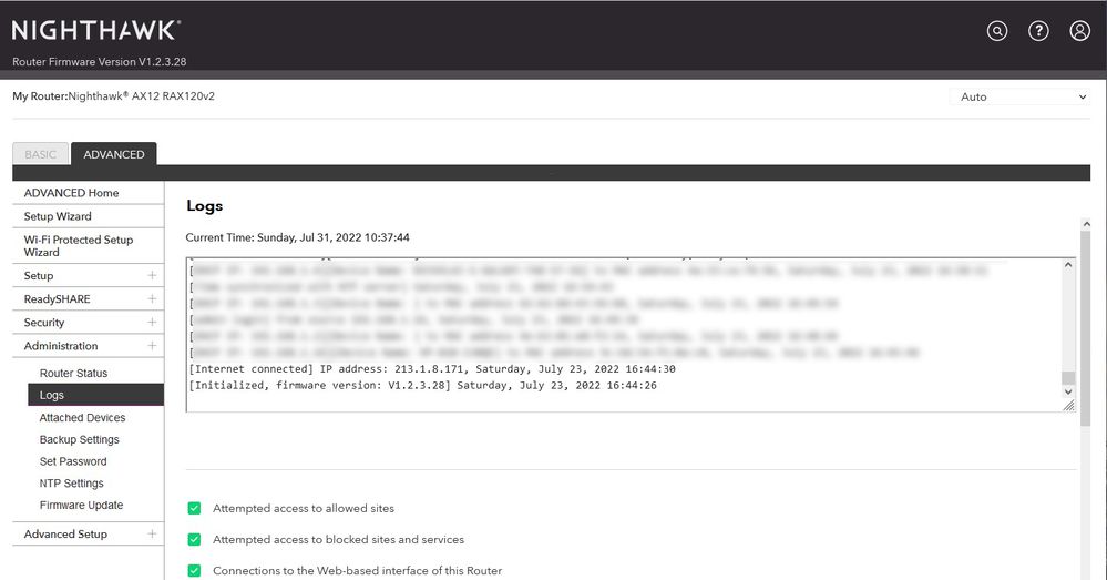

Here is my RAX120 V2 log that shows that the router did not restart since last Saturday when powered with UK / EU / Asia adapter Model ADS-65MIA-19 with the current firmware installed.
