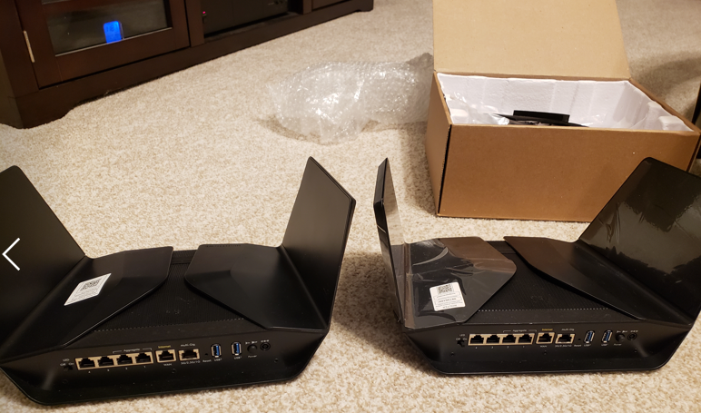

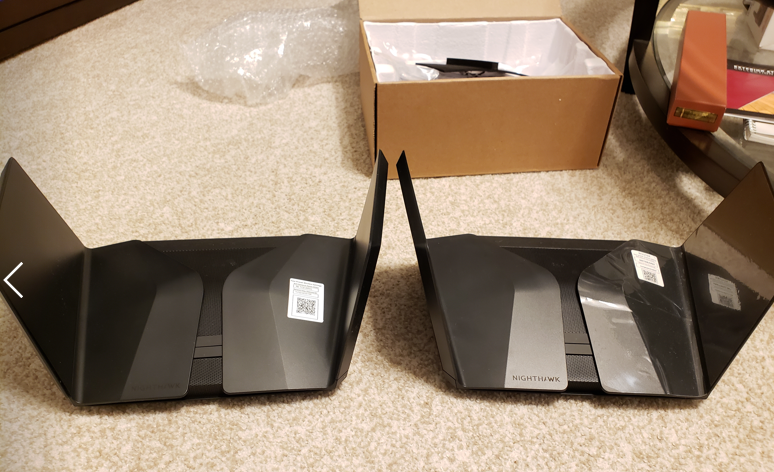

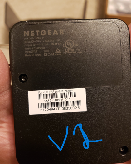

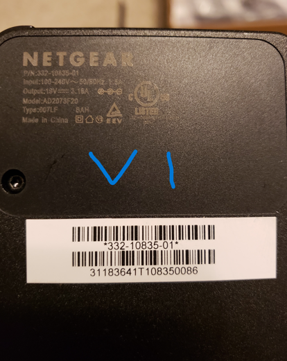

I was inspired to finally give do an RMA for my paperweight v2. Behold, like others I received a brand spanking new v1 unit. Set it up just like the v2 and 2 days no drops so far.
Couple of Notes. Power supply units are IDENTICAL. same model number and specs. Routers are also identical in size and shape, actually v1 seems a touch heavier. Left photos is the v1 and right photos v2. I'm hopeful the stability of the v1 will behave like the other v1 in our family.
