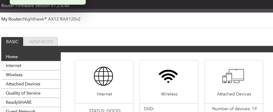

RAX120v2 keeps dropping devices ofthe Wifi hardwired devices remain good. Firmware V1.2.8.40
So my current firmware is V1.2.8.40 I have been having issues with all my wifi devices dropping. Anyone have a fix for this? I don't know why I suckered my self into another Netgear product. I am rea...

- EpicEnigmaJan 12, 2023Guide
Yeah but in the router page it says V2
- FURRYe38Jan 12, 2023Guru - Experienced User
UI I believe reads on both models but the serial tells the actual model version.

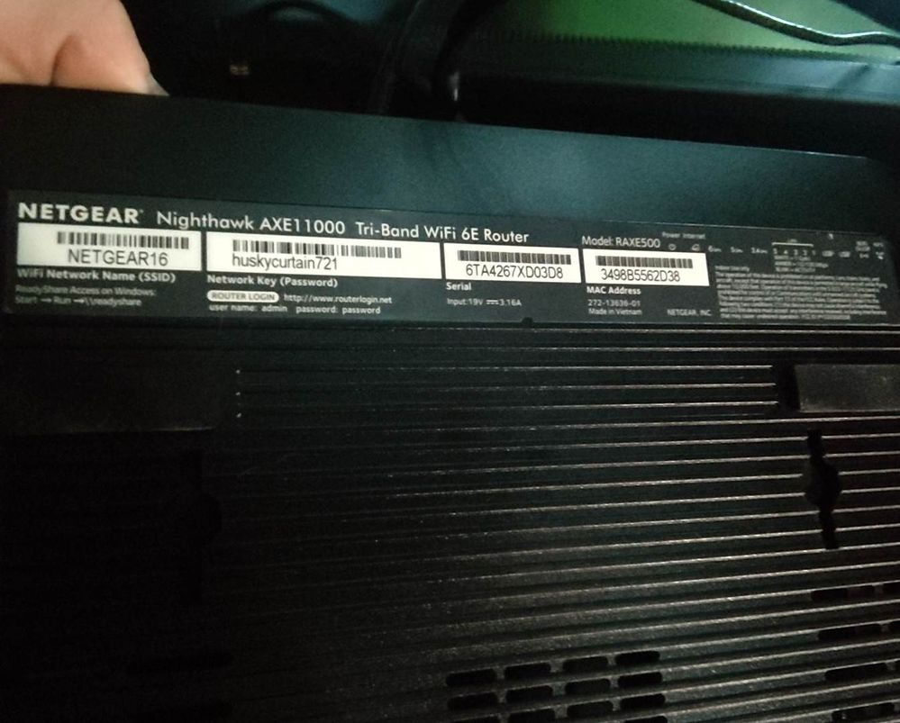

Sticker didn't tell me the default SSID and password either but the router login page did.

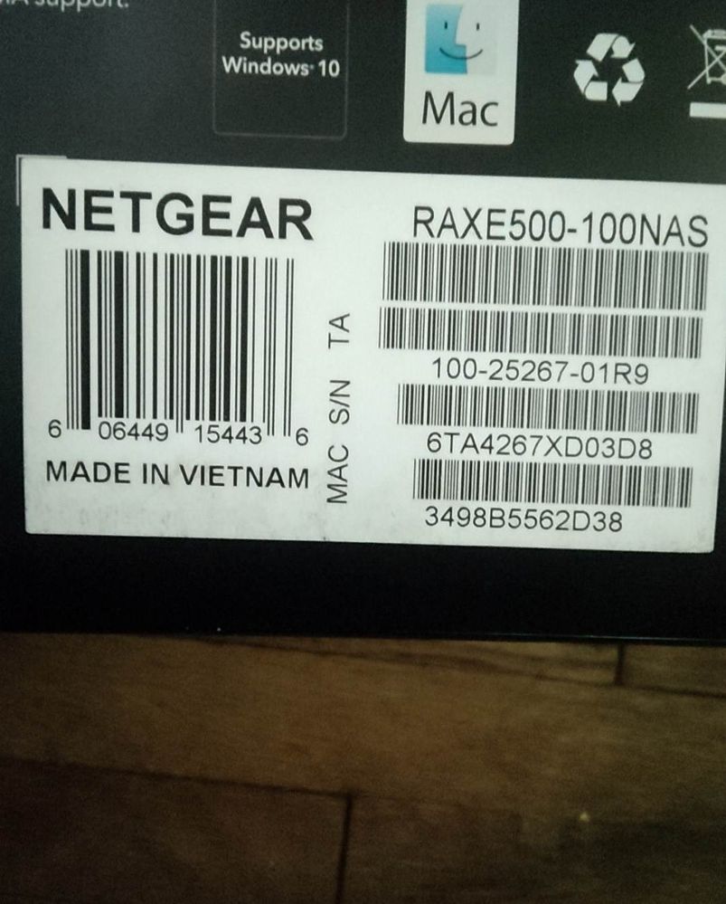

Can you post a pic of the serial number seen on the router sticker in back and edit out all but first three characters?
Dude, I am so angry right now, I can now see the sticker is miss aligned. I totally got ripped off... I think? So the box was for a V1 but I have a v2... free upgrade? I don't know how to feel right now 😅
Ya looks like someone did something with the router sticker in back. Possible someone had this one and it maybe a v2 and had problems with it and found them a v1 and swapped the sticker in back and put this unit in the v1 box knowing the v1s worked better.

I am curious. Does the MAC address of the device match the MAC address on the label?
No, from, what I can see of the label on the Box VS what it says in the IPv4 internet setup mac address via the router page, they are indeed different. Did you think maybe they did some custom firmware?

What upsets me is how do I register this for a warranty because the serial of both the box and the router both say registered. Its sort of an issue because the one hinge on the right side giant panel wifi antenna has come loose somehow. I do not think it will effect its performance but it is an eye sore cosmetically to such a beautiful unit. My secondary thoughts are, whoever registered said serials should catch trouble for frauding the system. If both serials are registered to the same email or person, than that person is point blank caught knowingly being responsible for this mess.
- KitsapJan 12, 2023Master
EpicEnigma wrote:No, from, what I can see of the label on the Box VS what it says in the IPv4 internet setup mac address via the router page, they are indeed different. Did you think maybe they did some custom firmware?
No, not necessarily. Occasionally hardware that is used in beta testing and evaluation programs finds it way back into the secondary market.
