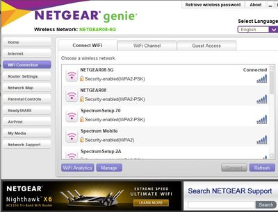

I have "netgear genie" on my desktop and thats how I initially login my router.
Once there, I have a menu on the left side of the screen, see attachment below.
As you can see, one other problem I have is that every night when I put my
system in "sleep mode", the next day my "WiFi" has lost its connection and I
have to reconnect my WiFi on my router. The fourth item on the menu is

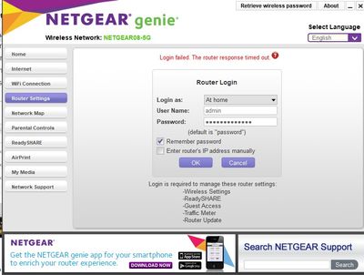

"router settings" and that is the menu item I cannot access. When I click on
"router settings" the system searches the password to log me in, but it "times out"
within 15-20 seconds.
Login is required in order manage any of the functions listed located at the bottom of the login screen.
Hope this helps clarify what I am unable to do.
