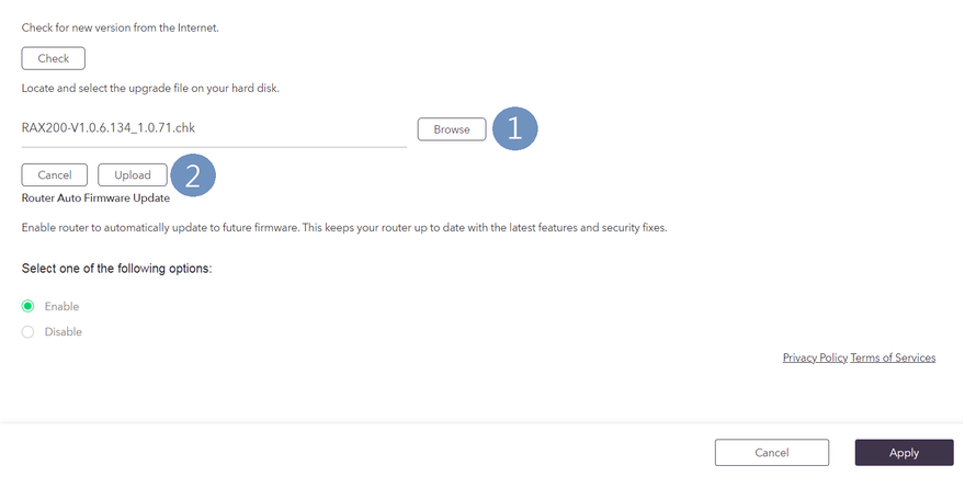

RAX200 latest firmware update 1.0.6.138 will not start
Regardless of how I try to update to this latest firmware release (mobile app or from PC-browser) the update does not start. When searching from inside app/browser it returns an answer saying I alre...

Does it give you an error?
Did you try a different web browser?
Are you trying to do it manually or using the automatic update option?

Now I've tried repeating the same procedure with both Chorme, Edge and Firefox. All with the same result - nothing happens. I guess there is something wrong with this update.

"nothing happens"
Does it error out? Does the page just reload? Does it give a notice of improper file?

Hi,
No, there are no error messages or anything. When I click on "apply" the page seems to reload but no update process is triggered. The only thing that happens is that the box where I pointed to where the update file is stored on the hard drive now is empty again, so have have to point to it anew.
Thanks for your previous suggestions. Maybe this update is not available for my country (Sweden) as both the Nighthawk app and the update search from inside the application page after I've logged on, say that I already have the latest update. But there is no information about country restrictions on the dowload page for RAX200. It is a bit confusing:)

powered my rax200 on and tried it and it worked fine. I'd try a different pc
