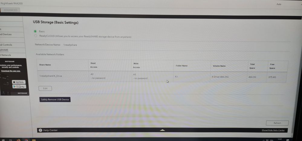

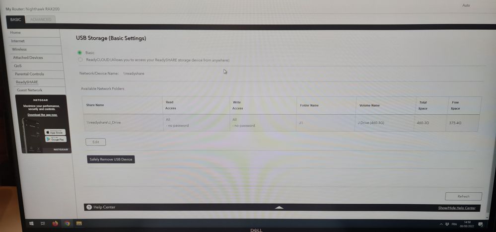

- UserRax200Aug 07, 2022Aspirant
drive name is J 10 min after (I rebooted the router using the GUI once)drive name was K 10min earlier
