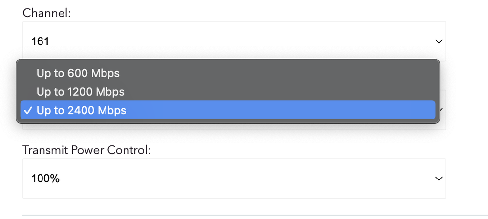

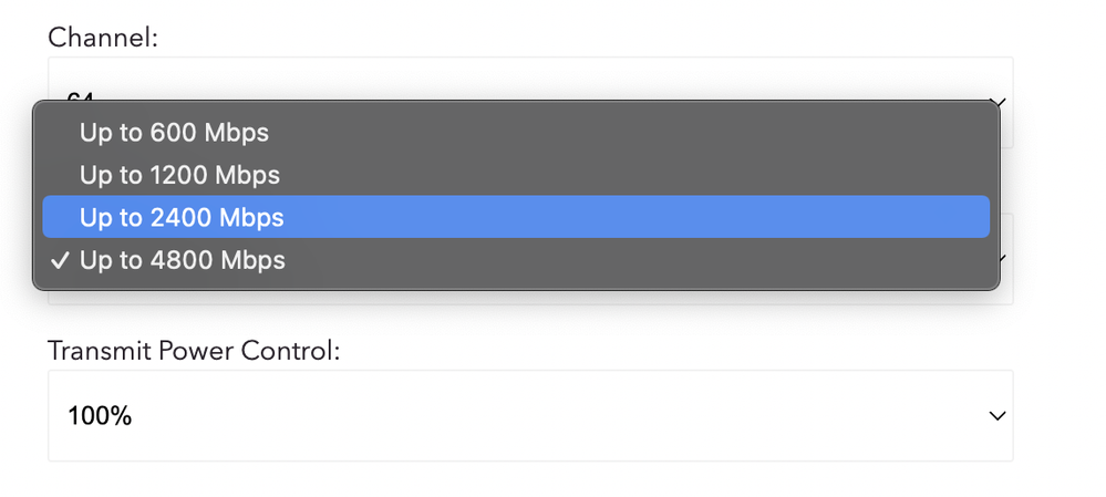

RAX200 Second 5ghz no 4800 Mode
Is there a reason on my rax200 I cant see the 4800 option on my second 5ghz channel? See sreecn shots. I can see the channels like 161 and such but it only has the option for 2400. On the fir...

my region is set to Canada.
and I can see channels 141 through 161

Thanks for your info, I understand how the channels work, I don't understand why my 5ghz second channel only show 2400 and not the 4800 it should show - the first channel shows up to 4800 but not the second for some reason.

- plemansMar 20, 2022Guru - Experienced User
Its related to your region.
to hit 4800mbps you need 160hz wide channels.
There's only 2 chunks that support that wide of channels in the 5ghz spectrum.
And Canada has a chunk of blocked channels right in the middle of that second 160hz wide spectrum.
https://en.wikipedia.org/wiki/List_of_WLAN_channels
