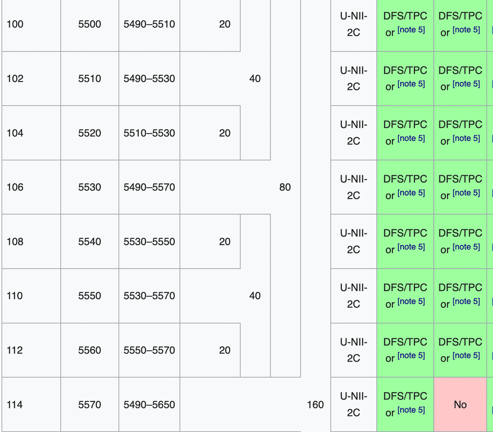

RAX200 Second 5ghz no 4800 Mode
Is there a reason on my rax200 I cant see the 4800 option on my second 5ghz channel? See sreecn shots. I can see the channels like 161 and such but it only has the option for 2400. On the fir...

for 160hz wide channels, it uses from channels 36-64 and then channels 100-128
The rest aren't wide enough to support 160hz. And canada has channels 114, 118-128 as not usable.
So in canada, you wouldn't be able to have 2x 160hz wide spectrums like the US (and some other regions) does.
So you're only going to get "up to 4800mbps" on one set of channels. The other will only support 80hz wide and "up to 2400mbps"

Thank you so much for that! so that is pretty much why I can't see the 4800
but what about these other channels 100-114? they have 160ghz and it looks like canada allows them?
- roninremyMar 20, 2022Guide
that really sucks lol
not that I thought I would get full gigabyte speeds over wifi... but I thought I would get better than half. but then again using a apple products and they only use 2x2 anyways
Thanks for the help everyone! I didn't think Canada would block off a whole spectrum of channels so we can't use the full functionality 😞
