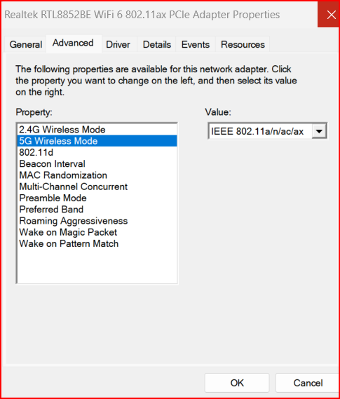

Kitsap,
I don't see the same details for my AX wifi card.
- KitsapMar 26, 2025Master
The properties shown in the screen shots I posted were for an Intel Wi-Fi 6E AX211 card.
The properties shown in your post are for a Realtek RTL8852BE Wi-Fi 6 802.11 AX card.
Different radio cards, different drivers, and most likely different brands of computer. Possibly different operating systems.
No reason for the details to be the same.

Your attempts to be straightforward are missing the mark by a significant amount. Suggest you go back and read your posts scattered over 9 months time!
Recently you post a properties snip from a Realtek Wi-Fi radio card that has not been previously mentioned.
A Wi-Fi connection from a computer is a negotiation process from the computer to the router depending on the router settings, the radio frequency environment at the time of the connection, distance away from the router, and other factors.
Different brands of radio cards and the drivers they use have different results. Neither the WPA3 or the AX standard are fully mature. Hardware manufacturers, and the drivers they use, do not establish exactly the same connection. The old adage, your mileage may vary applies here. And it may vary from day to day and computer to computer.
