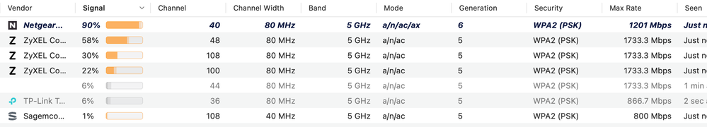

I factory reseted both the basement router and rax40 and set it into AP mode. Testing in the basement I get 500/500 mbps from both routers. With a wifi explorer app I can tell that in the basement the routers dont get disturbed by neighbours. Then when I bring the rax40 up to the living room I only get 50/90 mbps. Both cabels tested with are cat5e, the cabel in the living room is a few months old.
Looking at the wifi explorer I see many neigbhours, but only one on the same channel. I have tried changing channels from 38 to 48 without any luck. Could this maybe be an issue or could it be something else? Any suggestions what I could try now?

Not sure if the photo was uploaded but can write it manually. Photo dump from wifi explorer regarding the my neighbours network on 5 Ghz:
Wifi - Channel - Channel width - Band - Mode - Generation - Max rate
Mine - 40 - 80 Mhz - 5 GHz - a/n/ac/ax - 6 - 1201 Mbps
Basement - 40 - 80 Mhz - 5 GHz - a/n/ac - 5- 1201 Mbps
Neibhour 2 - 40 - 80 Mhz - 5 GHz - a/n/ac - 5 - 1201 Mbps
Neibhour 3 - 40 - 80 Mhz - 5 GHz - a/n/ac - 5 - 1201 Mbps
Neibhour 4 - 40 - 80 Mhz - 5 GHz - a/n/ac - 5 - 1201 Mbps
Neibhour 5 - 40 - 40 Mhz - 5 GHz - a/n/ac - 5 - 1201 Mbps
