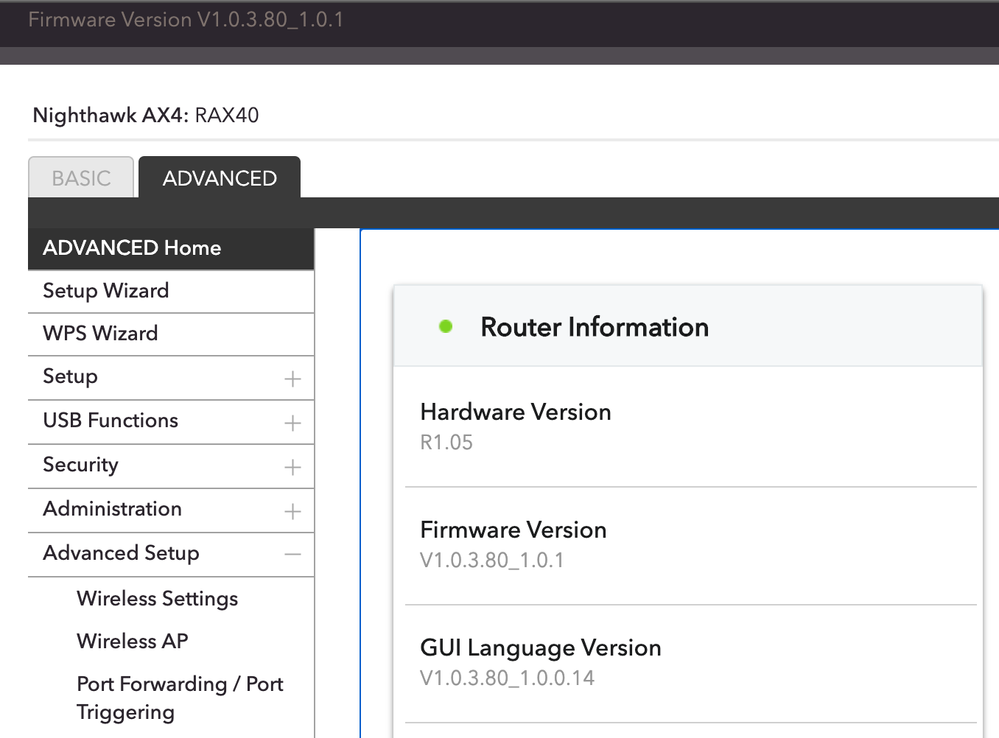

Yeah so probably a hardware component changed. And the firmware development teams are developping on the new hardware. That is why they can not fix it. They can not reproduce it on their devices.

I have a RAX35 with 1.0.3.80 firmware and my router just completely froze on me again requiring a power cycle. Only one device was browsing the internet so the internet load was very low. The router information page says its hardware version R1.05. The router is less than a year old and still under hardware warranty but out of technical support. Should I try to RMA the device?
