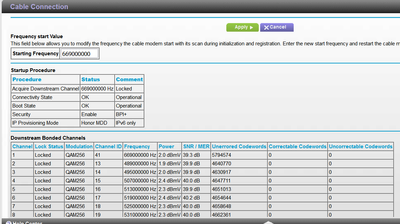

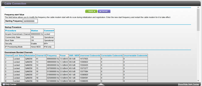

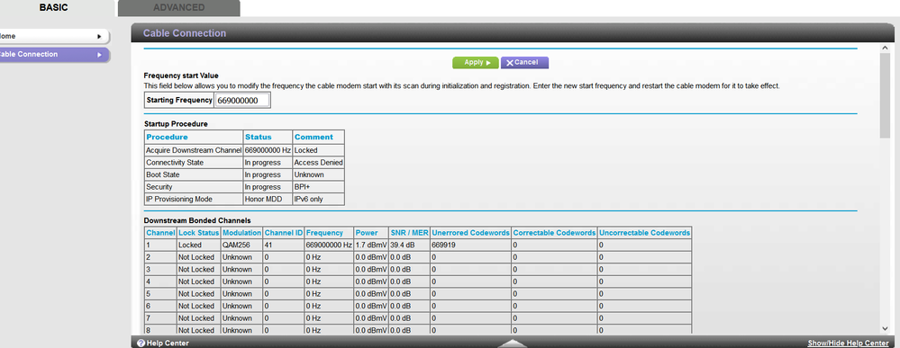

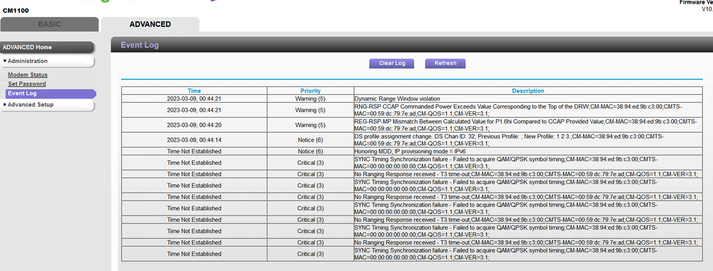

Thanks again for digging into this with me. It was kind of tricky to tether into the router to Admin the modem and keep the one connection-only condition going, but I did what I could here. When I triggered a failed state on the modem - which I've narrowed down to connecting any device to the WiFi - I pulled the connections from both Netgear devices and immediately tethered into the modem again. Pulled failed state logs and Cable Connections page.
- I had originally seen an almost auto-drop behavior before. This was because I renamed the defaulted configuration's SSIDs back to the original name/password from prior firmware update on the RAX45 Router, so multiple devices were reconnecting and crashing the signal. Same deal with new SSIDs and only my phone or laptop know them now. Auto-connect is disabled on both devices.
Is it normal to see an "Access Denied" Connectivity State (occurred during failed state)? Or is that a byproduct of the hot swapping of cables I was doing mid-stream?
Also, the logs are showing sync errors. It almost presents like when switch hardware loses its NTP server timing. I've tried connecting using my Samsung notebook and Samsung S23 to WiFi so I'm confident I've ruled out some crazy systemtime or Windows Date/Time off sync issues on my PC. FWIW, I have seen Windows fudge Date/Time before on this PC but it's really uncommon and internet works fine when physically tethered to either Netgear hardware.

Failed state - had to pull out of the router and tether into the recovering mdoem (one connection only!)
Previous working state (not connected to wireless)
Logs from post-failed state - very similar to functional state logs
Recovered state (not connected to wireless)
