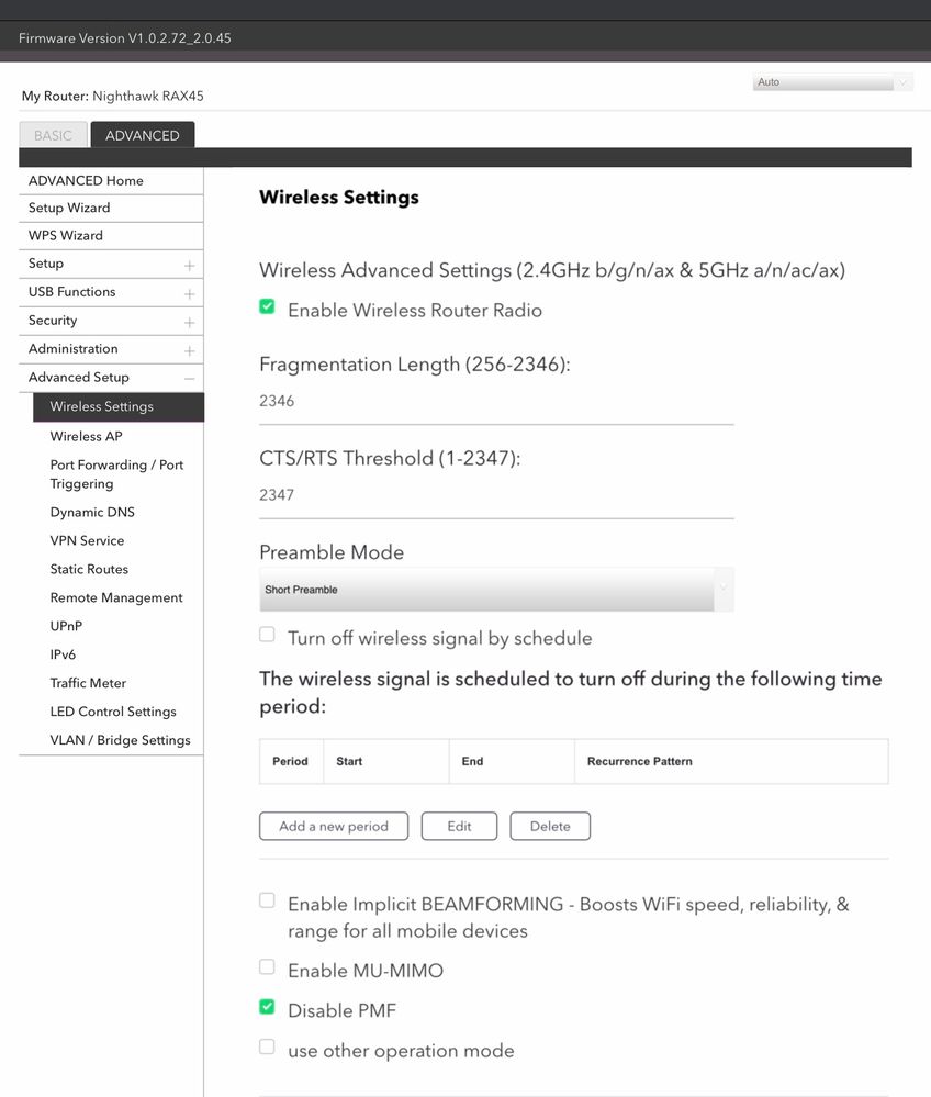

Here’s the settings I’m using that’s providing the speeds I’d expect. (See screenshots)
Everything that you see unchecked will stay disabled. The WiFi settings that are currently enabled will need to first be disabled, the router reset, and then enabled/applied after the reset.

Do you happen to have a link to an imgur pic? I tried your link, but it says the photo is unavailable. I'm desperate to boost my speeds.

I tried the settings from his screenshots and they worked like he said! I am grateful for his help. I would like to share them with you since i saved them. Hope it works for you as it did for me. Cheers
- EdgarPoeJan 23, 2021Tutor
I'll try one photo at a tme since it didnt let me do them all at once.
