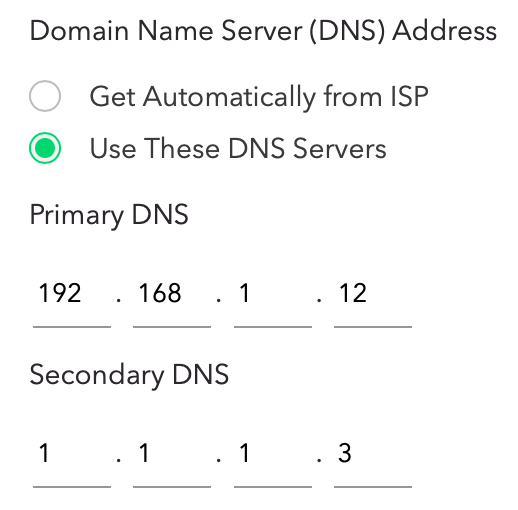

I'm setting the DNS under the Internet config (see first screenshot below). The 192.168.1.12 address points at my Pi Hole DNS server, and 1.1.1.3 is a family friendly DNS provider. I've confirmed that both of these work correctly when queried directly, or when the client DNS settings are overridden.

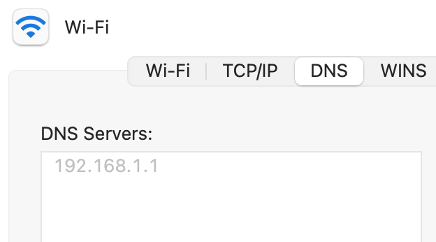

When the DHCP lease is renewed, the router's address is the only DNS server provided to the clients (see second screenshot, below) -- and it regularly hangs when attempting to do DNS lookups.
