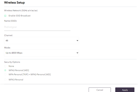

RAX50 5G setup greyed out
I have an RAX50 running FW 1.0.11.112. 5G wireless is no longer working, when I go to wireless setup it shows the Enable SSID Broadcast box checked but it's greyed out, like something else is overri...

Well, I think I found the issue, I selected Enable Smart Connect and it must have greyed out the 5G setup area. I unselected it and my 5G setup is active now.
