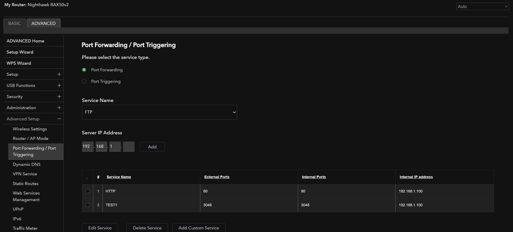

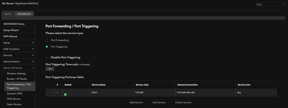

      Please post a screen capture of how your attempting to configure PF or PT.
      I just set a PF and PT rule here and it took:

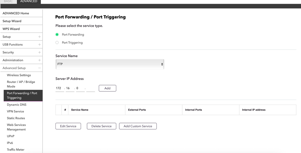

  • My ISP is Kyivstar Broadband (https://kyivstar.ua/home-internet). The cable goes from the provider's switch in the attic of the house to my router in the apartment, so yes, I can say that it is connected to a wall jack. I am attaching the screenshot you requested. Port list is empty because I do not have port forwarding, and all ports are free.

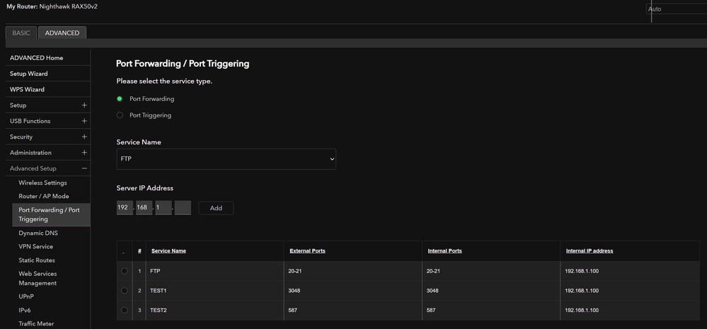

      I'm just adding my PC connected at .100 for the server IP address to check this:
      Using MS Edge in Windows 11

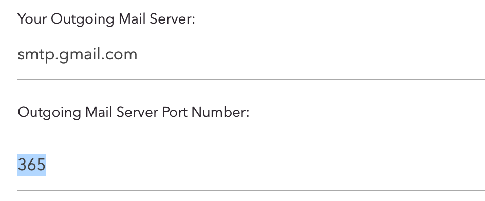

    • Outgoing mail server: smtp.gmail.com
    • Port number: 365
    (I have never attempted to set the port number incorrectly, and thus am not aware if the router is "smart enough" to reject invalid entries.)

      Regarding error messages: if I leave the Port field empty and click Apply, I get the message "The port number must be less than 65536", and if I enter any number there, the page reloads, but the number in the Port field remains highlighted and the changes are not applied. I have attached a screenshot
