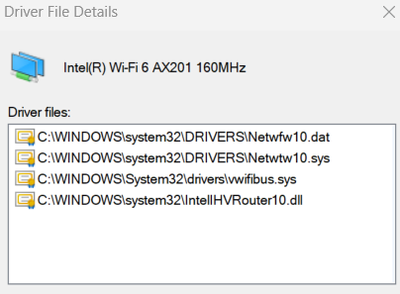

    what actual driver is on the wifi card?
    Have you tried a USB based wifi card to see if it is specific to the current card?
    • Wundbar's avatar
      Wundbar
      Plemans
      Drivers are
