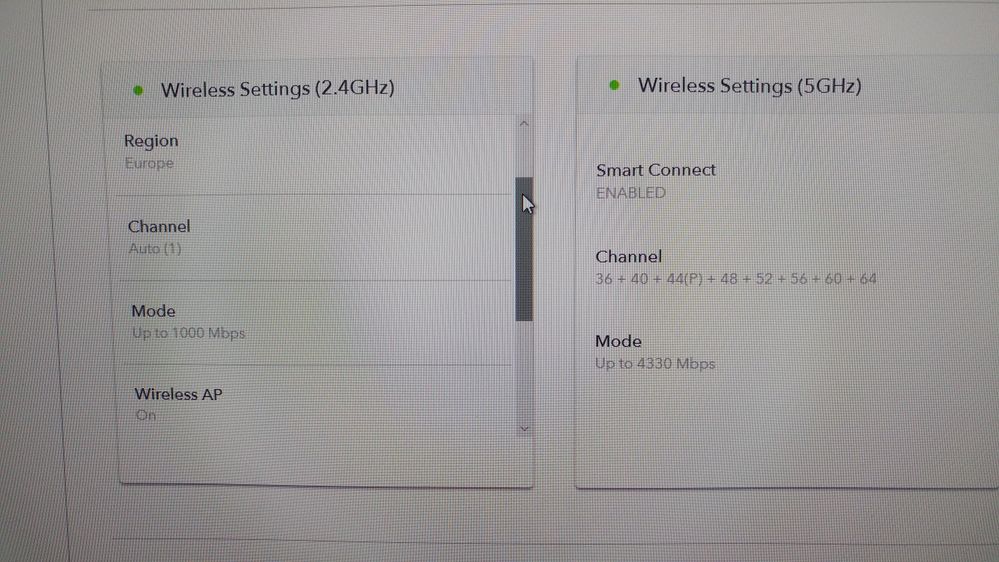

My router has been in meltdown again this weekend with probably 50% downtime with nothing able to connect.
No devices were connected to the 2.4Ghz band at all (sonos, cameras, phones & televisions were all offline).
Reboot via Nighthawk app & phyiscal power button made no change, still no Wifi connection.
I logged into the web interface to see if I could try to disable something else.
i saw that 2.4Ghz was using Channel 1 (selected by Auto). - see image at the bottom.
I am running the latest firmware (46) which states in the release notes:
" [Bug Fixes] Channels 1, 11, 12, and 13 will no longer be used when the 2.4 GHz channel is set to Auto. "

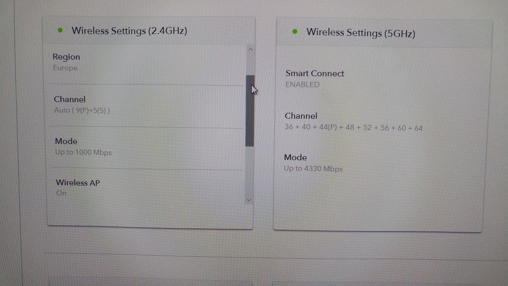

I then changed the timezone for the NTP server which was wrong & the router rebooted.
Afterwards, all my devices came back online & I noticed the 2.4Ghz channel had changed to 9+5 (see image).
This gives me many questions?
Why are channels 1, 11, 12, 13 not used in Auto mode? These are just standard channels in the 2.4Ghz band?
Despite this change, the router still seems to select channel 1 (bug in the new firmware or wrong release notes) ??
Could this be the main cause of the connection problems that some of the channels are not working correctly?
I could understand if it was some of the exotic 5-ghz channels but 2.4ghz is more than 10 years old....
Ch1 - NOK
Ch 9+5 - OK
