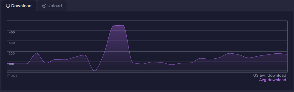

I have 400 Mbps download speed from Spectrum and from the beginning I've been getting about 80 download speed on all my wifi devices. Upload has been a steady 20 Mbps. I followed the suggestions in the post below and the only difference I made was I switched the IPv6 to AutoDetect.
I have Firmware Version V1.0.3.106_1.0.50, and this has been happening for about a year so it's not a firmware issue. With the suggestions provided in the post above, I was able to get 400 download speed once and that was it. I thought it all worked out. I waited a few hours, tested again and I'm down to ~150. Still better than 80, but that's less than half my speed. I've restarted the router to see if it just happens only after restart, that wasn't the case. I've tried turning on QoS, still at 150.
This has gotten quite frustrating. I have AX enabled and SmartConnect on for the dual connection. Anyone came across something like this?
