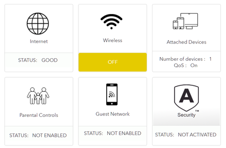

RAX80 wirelesss cannot be turn on
The router wireless function turn off suddenly without any modification to the setting, the wired connection is not affected and are working fine. the WiFi and WPS light is lighting up all the time. ...

- PurpledeerSep 27, 2023AspirantThank you for your reply!
The temperature is normal. Same as before when the WiFi function still works.
The WiFi didn't turn on and stay like that even after the factory reset. It's like disable by default. The WiFi didn't work at the beginning after factory reset and nothing is broadcasting, even no hidden SSID. The wireless page shows 'wireless router radio' and 'SSID Broadcast' are enabled.
I tried Auto and all channels including DFS channels but still no luck and now are leaving it on Auto. There are around 10 WiFi neighbor nearby.
WiFi devices connected before are mainly phone, tablet, laptop, PC and NAS, but now is only the wired PC and NAS because only the wired port works.
It's a Huawei HG8045 router and modem combo with WiFi function disable. It works fine and other router connected to it works fine too.
I am using an AMP CAT6 cable and double check it is working fine. So I don't think that is the problem- FURRYe38Sep 27, 2023Guru - Experienced User

Try option #2 first..- PurpledeerSep 27, 2023AspirantTried a 30-30-30 reset and it is still the same so I believe it is a hw failure. Unfortunately my warranty is ended so I think I need to purchase another router instead.
DMZ is already configured on the modem before so I don't think it's the main problem too.
