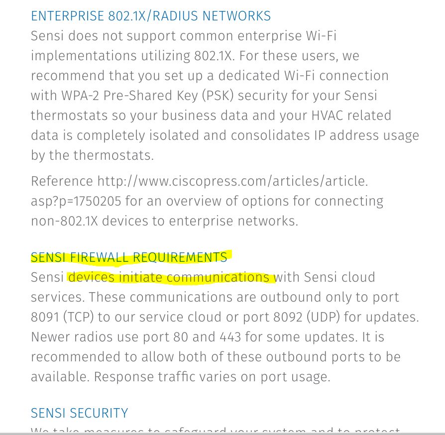

However, this is what Sensi does document:

- VideoGuyJul 30, 2024Star
I was unable to post under the original thread for "RAXE300-100NAS will not accept port triggering rules", but I have stumbled across my solution by accident. The "Service Name" that you select for a port triggering rule cannot contain a BLANK character. For instance, you cannot select "UDP 8092", it has to be "UDP8092". If you include a blank character, it just ignores your request and returns to the rule table without any error messages. With that simple fix, my frustrating Sensi 2 Thermostats are now working 100% with the cloud I/O.
