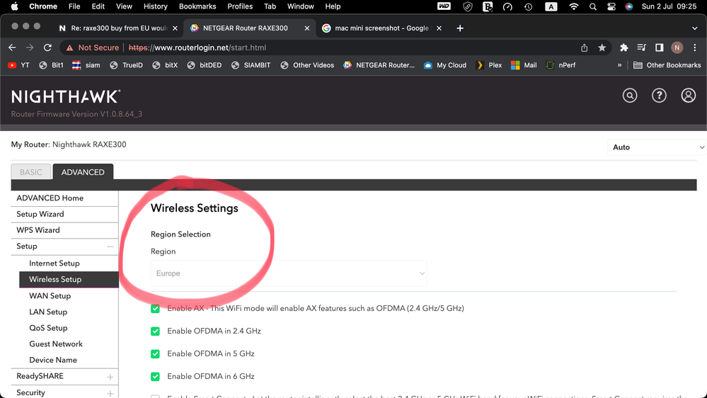

raxe300 buy from EU would like to change region to singapore, how to do ?
i order raxe300 from EU and bring router to use in south east asia, i would like to change wireless region from EU to singapore (region selection is gray) i know firmware base on where is the manufa...

it's gray area cannot do anything

Hi
I have bought RAXE300 and RAXE500 from Hong Kong authorized dealer.
RAXE500 can change region code to other Asia Pacific countries, e.g. Japan, Korea, Hong Kong...etc
But the RAXE300 which I bought from Hong Kong with same distributor, it is LOCKED to Europe.
I cannot change the region code. the label at the back is Netgear UK. (RAXE300)
I just found Wifi6E frequency channel in UK is the same as Hong Kong.
Those government blocked reserved frequency is the same in HK and UK.
RAXE500 which don't have Netgear UK label at the back, it do not specify country as RAXE300.
but region locked to Asia Pacific countries. I cannot change it to Europe or USA.
If I want to use ALL frequency in WiFi6E, I can change the region code to Korea in the RAXE500
but seems NO solutions in RAXE300.
