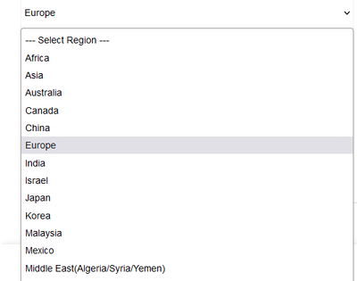

      Not quite. US models are meant for NA but Europe ones work everywhere.
      It is the US that locks the region. Buy in Europe and you can change to wherever you like.
      Here's my choice.
